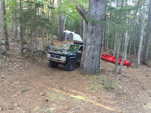

My old WD21 worked great. Drove over 1000kms with it last weekend camping and exploring the south shore of Nova Scotia. It is going to need an exhaust leak repaired and I wish it had a bit more power for the hills but it was comfortable and reliable on this trip.

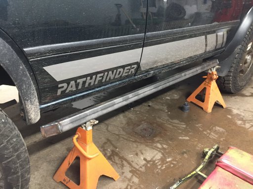

Those turned out nice. How far do they stick out from the body?
just enough to protect rocker and bottom of my doors. I don't have completely finished yet. I had to help out my brother with his GX470. Was due for the timing belt replacement.
Finally getting the rock sliders finished up. They just need sandblasted and painted.

These sliders clamp all the way around the frame and will be easy to take off and on for any repairs. They tuck up very close to the rockers I had to notch them so they don’t hit the pinch weld area of the rockers.
