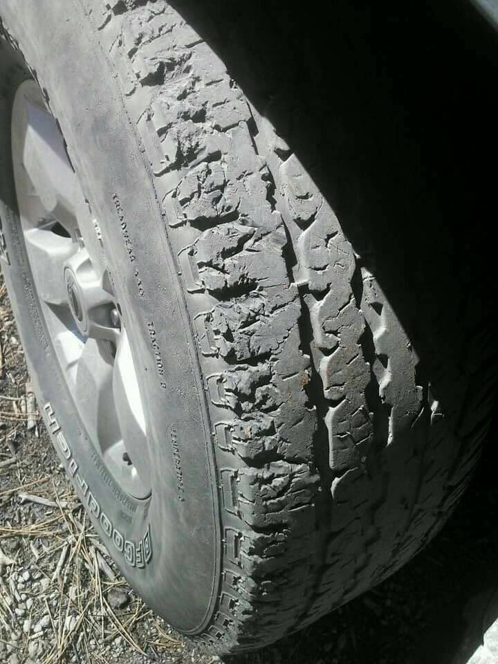

Here's one of my tires after my first trip to the high Sierras 10 years ago. Keep in mind, I grew up wheeling forest trails, so airing down wasn't a big "thing"
Now, I run like 16-18 psi religiously, lol

Oh and here's my tire... pretty damn sure that if it was aired up when I was wheeling in those sharp rocks I would have had a sliced sidewall.
Notice all the cuts near the white portion and the deep cut all the way into my tread.
(almost time for new tires... this is now my spare)
