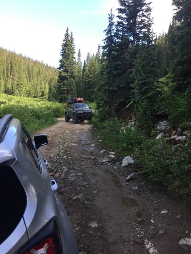

I stumbled upon a stuck Jeep Renegade up in Crested Butte a couple weeks back where I really wish I would have had an inflatable jack. The vehicle had slid off a narrow road and nearly into a creek. It had no recovery points. It was high centered under the engine. An air jack could have lifted it up to allow stacking rocks under the wheels and probably driven out.
I ended up winching it out by attaching to its wheel. While it worked it was definitely not my preferred method.
On a side note. This Renegade did not have a spare tire/jack/recovery points. While I'm not familiar with the different trim levels I'm going to assume it was the entry level. If your going to go explore the back country in this type of vehicle please make sure you have some of the basics. What I found most appalling was that the Jeeep did not even have the little threaded eyelet that screws in front or back for recovery. It had the places for it but the actual eyelet was an option according to the owners manual. This advice applies to all in AWD type vehicles which I see more of every year out on the trails.
