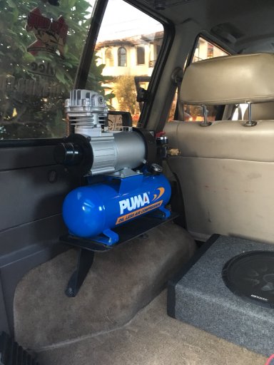

My Puma 12v compressor, rated at 100% duty cycle, is wired to my 2nd battery. It will inflate all 4 of my 33s from 15 to 40 PSI in about 9.5 minutes. They are available for about $250. I built a little spider hose setup that allows inflating and deflating all four tires at once, and is long enough to reach a 2nd vehicle parked directly behind me.
Here is a kinda rough shot showing how I have the compressor mounted and testing out my bumoer-mounted air hookup.
