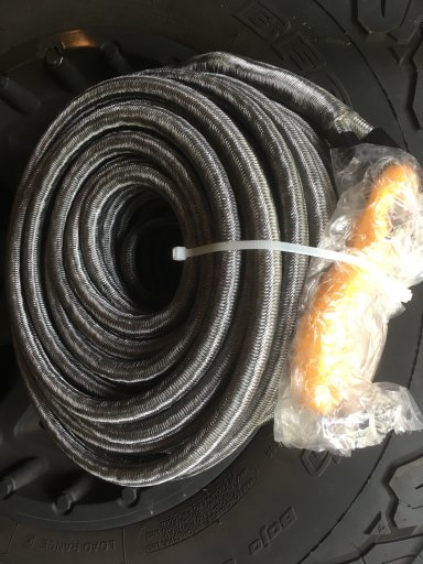

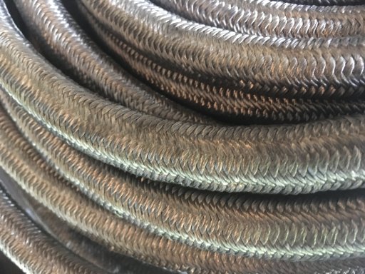

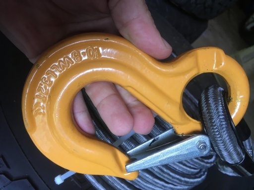

This the Ranger synthetic rope from Amazon. Hook looks heavy duty, makes mine look like a toy, hopefully the steel is good quality. All I can see is the rope protector, it is very tight on the rope and heavier than expected. Shipping weight was 7lbs. Will see if it all fits in the winch later today

Working Load Limit (WLL) on that hook is 3.2T? Am I reading that right? Seems like it should be more than that.
Aren't typical 3/4" D-Rings WLL 4.7T or something?

Not sure, but the line didn't fit, not even close to fitting, it should be labeled as tow truck winch rope. It's going back.

I looked up that line on Amazon. Seems like the Dyneema is 1/2" and then the jacket goes over it making it even thicker(?). The picture does say "Warning this rope is huge".
Usually you want the line to birdcage, where you push it together with both hands and you can inspect the inside of the line. Internal abrasion damage can go unnoticed if you don't check it. That jacket prevents access to the line and would be almost impossible to wash as well.

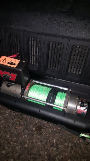

I got 100 foot 5/16 line synthetic for $100 off Amazon with 13000 lb strength on my 9000 pound Waren winch already put to use pulled out a full size Dodge Berry to the doors in mud no problem if the Rope is rated for a certain pounds you should be okay regardless of price!!51aC-lmBfrL._SY400_.jpg 20170723_203908.jpg
