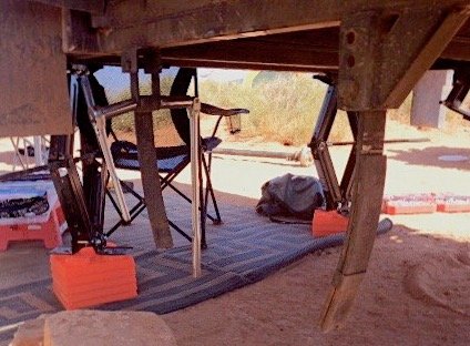

here in southern california, we're mostly on concrete for the freeways around the cities. If i'm using the trailer for utility purposes and the trailer doesn't have any weight, it bounces a decent amount when going over the joints between slabs or spots where they seal up cracks. put some weight in it, and its not bad. when i was going through utah a couple summers ago, i was cruising at about 80 mph and it was smooth, but then again it was asphalt that wasn't beaten up. i will probably be getting that shock kit soon since i will start putting my motorcycle in the trailer when going camping, so smoothing out the suspension as much as possible would be a good thing with as big of a bike that i have (klr 650).
