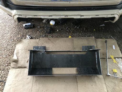

It is winch bumper build time. Went to the metal yard this morning and got material and then headed over to the laser cutter to get a couple of bumper base plates cut out.
Foam board mock up.View attachment 35380
Cad drawing.
Prototype..
More to come laterz!

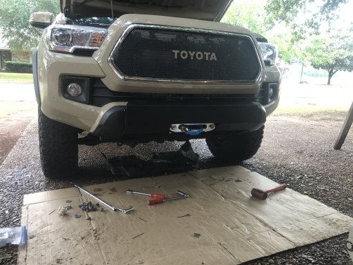

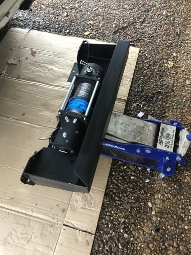

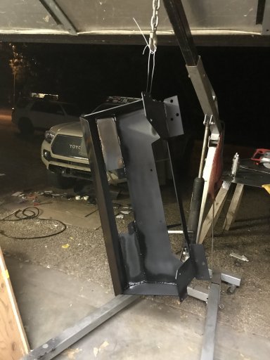

Ok I have the 95% of the bumper fab work done. The only thing left is the second set of frame braces but they are going to have to wait till I build my skids. What I have now is probably more than 75% of the Tacoma bumpers out there have. The frame braces are painted and installed. The bumper is hanging from my engine hoist with the paint drying. I'm taking a break from cleaning up my mucking fess I have made. Any who y'all don't wanna read all this crap so here is some pics.

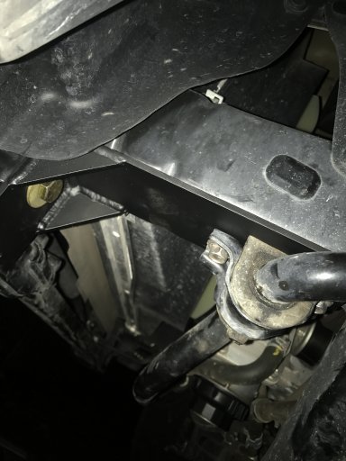

Lower frame braces welded out.View attachment 35599
Painted and installed.
I reused the outer 6" or so of the lower valance. The clips that hold them on are part of what was damaged when I hit the coyote so I added a body bolt and Jclip to the edge of the bumper cover to hold them on now. This location sucks the valance pieces up close so no gap around the outer edges.
View attachment 35600 View attachment 35602
There you have it one painted bumper/winch carrier hanging from a hoist with wet paint on it.
Pay no attention to the mell of a hess you see in the background. It has been a busy last few months.

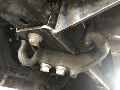

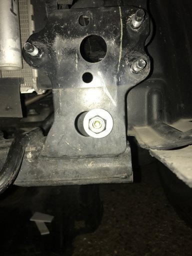

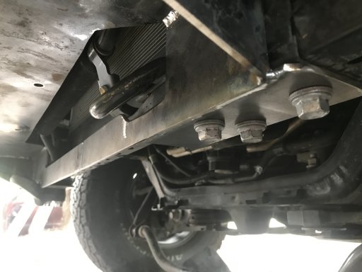

So where all do your reinforcements tie into?
The ones that are on the truck now are bolted to the same location as the sway bar. The 1/2" bolt that ties them to the winch carrier front to back is sleeved with 3/4" .120 wall DOM tube through the frame to keep from crushing the frame horn.
View attachment 35613 View attachment 35612
I also tied into the front cross member with six 12mm fasteners. View attachment 35610View attachment 35611
When I build the front skid it will also tie into the bumper and further reinforce the lower edge of it. Time is my only limitation here and now. The chances of needing the winch between now and when those items are completed are slim. I also have plans for braces on the vertical sides of the frame that tie into the stock bumper mount. The bolts that pass through the frame there will also be sleeved with the DOM material.
