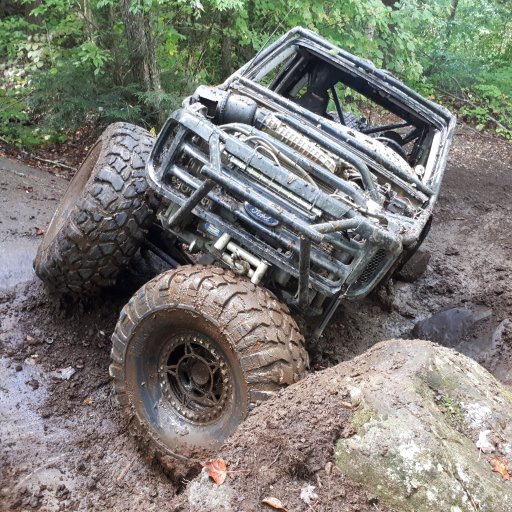

It's always good to know how to fix or patch a rig back together to get off the trail. I have been places and met people under that circumstance alone. The rig in the picture, I had never me the owner before, he came up and obstacle with too much wheel spin and the driver's front tire grabbed a rock. That in turn broke the u-joint, which opened up the ears on the axle shaft and blew the ball joints out of that side of the axle causing the wheel to o ly be held to the vehicle by the steering as seen in the picture. We ran a snatch block to a tree and winches the truck up onto 3 wheels from the roll cage, replaced ball joints (he sent his buddy into town for parts) and he drove out of that trail in 3 wheel drive lol.
