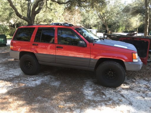

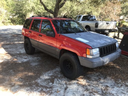

My plans are for a good all around overland vehicle with custom camping amenities and the ability for long trips. Here’s where I’m at so far.

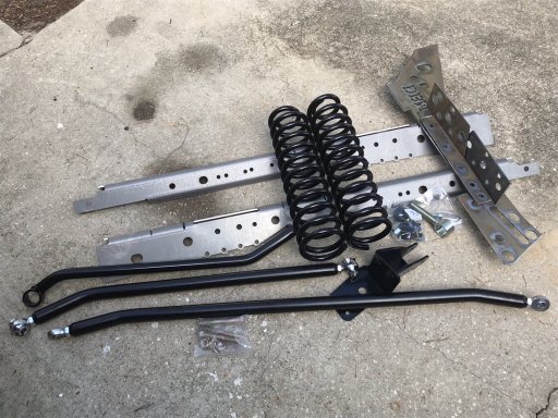

So I’ve had several but I’m hoping this is the last one so I can stop swapping parts around. I’m currently working on the motor between my last jeep and a few more parts that came in, I’ll be replacing everything except the block for the most part. The replacement highlights would have to be my new high flow headers that I’ll be wrapping, WJ intake mod with webbing trimmed out, injector upgrade, all aluminum radiator and some other goodies. I also have a long arm front and short rear lift all I need are my new Fox shocks and new coils to finish that. Additionally I have 2 full interiors that I’ll be going through to come up with a clean hopefully brand new look with updated carpet and headliner.
Body wise I will be doing the normal trimming of the fender wells, and additionally cut the old rocker panels and replace with 2x6 anchored to the unibody. Frame stiffeners and new under body coat will be added to keep it clean and beef it up. I also had a vented hood from a 5.9 project that I put on it to help air flow.
That’s about it I’m sure I left stuff out but I’ll add pics as I progress and would love helping any others with zj questions or if anyone’s searching for parts, I have had zjs for almost 15 yrs now and love em so I have different lists built for bolt/bulb sizes along with fluid amounts and types.
View attachment 95975View attachment 95976

Yea that’s a clean looking zj I’m def a fan of simple but capable when it comes to the grands. I have an iron rock critical path (long arm front) that I took off another zj I had but instead of the 7” I’m swapping the springs for 4.5 since I’m not really crawling in Florida. The Heim’s are only on the axle end for the long arms and reg bushing for the rear.

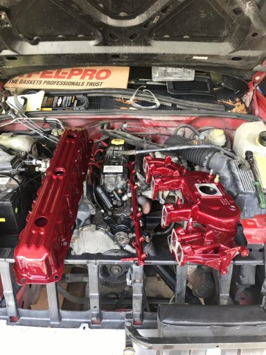

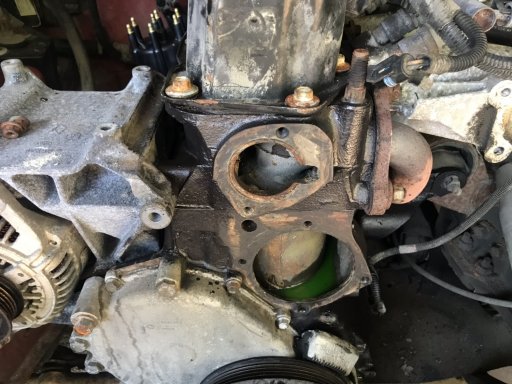

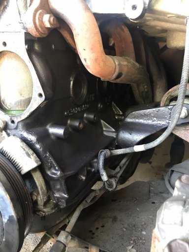

So I started tearing into the motor today got most of it apart and drained most fluids so tom I will finish taking it apart then finish the couple mods I have and put it all back together. At the end I’ll show a before and after pic of the engine bay.

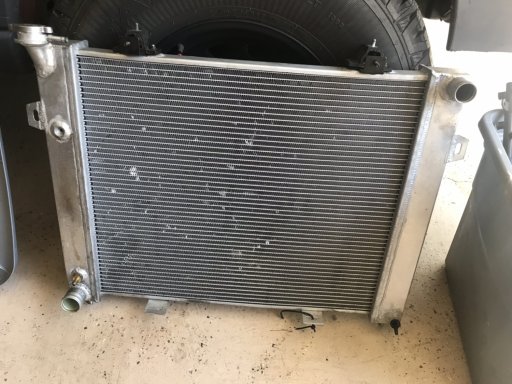

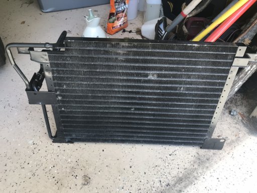

Here’s the new (off my previous jeep) aluminum radiator
New condenser

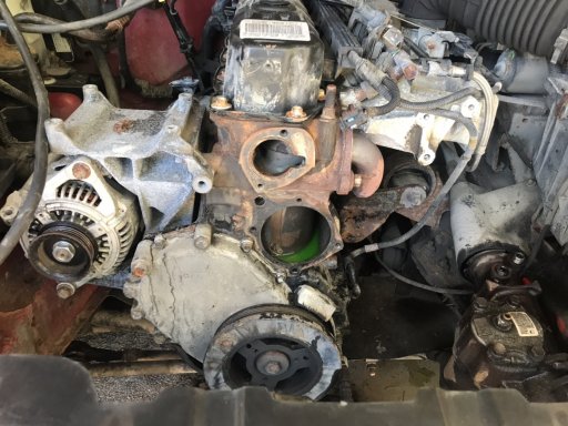

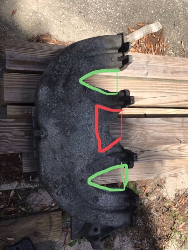

Intake upgrade and webbing being cut, green is what’s done red is tomorrow

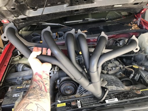

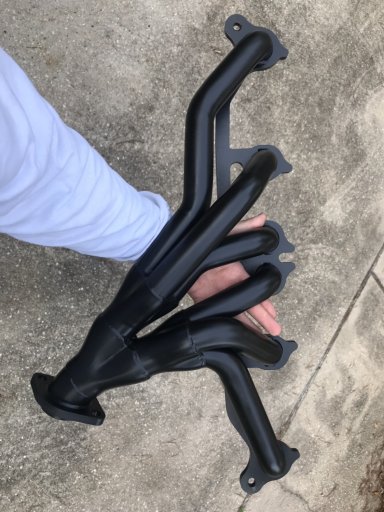

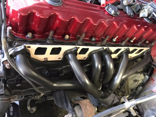

New headers that will hopefully be wrapped tomorrow

Very clean. What are the perks of using cerakote on that application?
I did it mainly to help reduce heat in the engine bay since the Grand Cherokee is known for running hotter. It also helps prevent corrosion from salt and what not on the outside and helps reduce corrosion inside the headers from heat, protects from road debris damage and is also chemical/oil resistant. The big plus is my header should stay black instead of fading or changing color from the heat it’s moving. Also after I finish building the exhaust piping I’ll coat it the same for the same benefits.

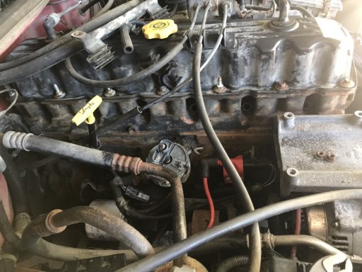

Got a little more done today, did the new distributor and waterproofed it, also had to redo my timing, finished painting anything I missed, got the valve cover/header/intake all mounted. Just gotta finish hooking everything up, then I’ll start the radiator support and steering brace. View attachment 104448
