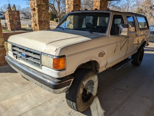

I keep getting asked for pictures, so here is one of Lycanical safe at home after a trip into town for breakfast and groceries:

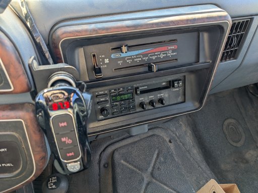

And here is one of this awesome little cheap Bluetooth FM-Transmitter (RoadTripper Sound) I bought to listen to music and have hands-free calling:
Those sliding A/C controls bring back memories of my moms 79 F100. Lol! Love what your doing. Keep it up.
My first vehicle (in my name) was a firetruck red 1992 Mazda Navajo, so when I got the Centurion it was like a blast from the past with the majority of the controls / radio / temp controls being the same. All I need now is a Sony Discman with one of those cassette adapters and I'm back in my teens HAH.

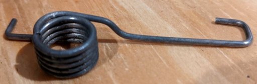

Anyone know of a place that makes custom torsion springs in small batches? I had two break, which I believe are made of galvanized steel. They are from the door lock / latch assemblies inside the front doors.
