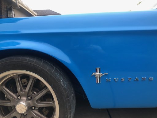

Whichever route I decide to go the Bed will be painted black and the cab will be painted "Grabber Blue" which is the same color I painted my mustang (see below)
