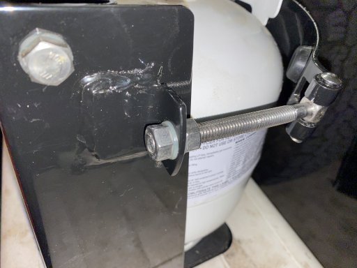

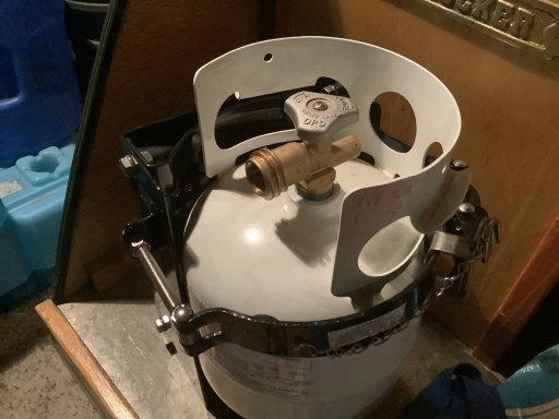

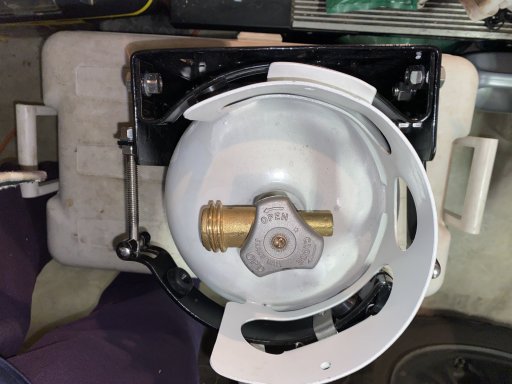

do you happen to have a photo of the tank in the bracket?
I had to do some adjustment to the retention strap, but otherwise good to go.
