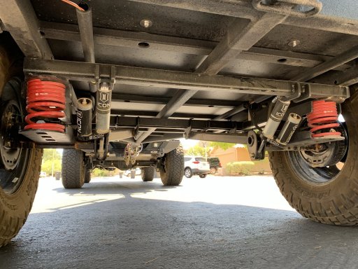

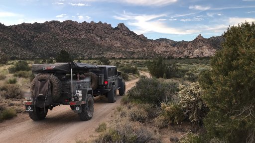

I have a 2018 Jeep JLUR on 37s and my Turtleback Getaway Trail is sitting on 35s. As mentioned in some of the previous posts, the new transmission is great and honestly it handled my 37s with without making any changes other than remapping the speedo with the Taser JL module. That being said, a re-gear was necessary in order to effectively pull my trailer when going up hills. My vehicle/trailer combo was purpose planned so I new from the beginning that I wanted to go with the 35s on the trailer from the get-go. The design of the trailer frame and suspension matches perfectly level with my Jeep as it sits with its configuration. There's really no need to put 37s on the trailer although it does accommodate the bigger tires without any issue. Here are the specs of my setup:
2018 Jeep JLUR
TeraFlex ST3 (3.5") lift
37" tires on 17" wheels
Re-geared to 4.88s
Icon suspension
Max Coupler hitch
2018 Jeep JLUR
Re-geared to 4.88s
Icon suspension
Max Coupler hitch
Congrats on the Turtleback trailer, you'll love it. I've taken it to some pretty gnarly places and at times forgot that I was even pulling it. Feel free to reach out to me with any other questions you may have. I live in Phoenix where they're made and have spent a lot of time at the factory and camping with the owners of the company. I'll be glad to send pics of my customizations to the trailer. Haha, now that I think about it, I need to post some pics up here on the forum!
