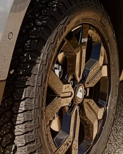

Some update here and also a big sorry für not giving response to DMs. I was very busy last months with the restauration of my girlfriends Miata. Took me about 150hours of work to put it back on the streets again.
Duster arrived and driving with it really is a pleasure. We made a trip to the baltic sea - Island of Ruegen. Drove well, took about 4,7litres of Diesel on 100km
After this trip, tires were changed.
General Grabber AT3 in 215/60R17 96H are performing very well with this car, especially while hunting.

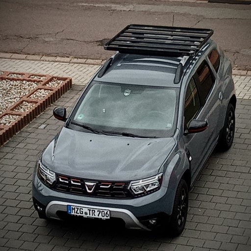

Front runner roof rack and cargo barrier was installed as well as a trailer hitch.

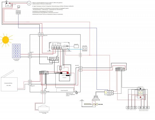

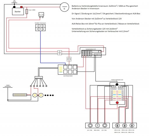

Good morning and happy new year to all.

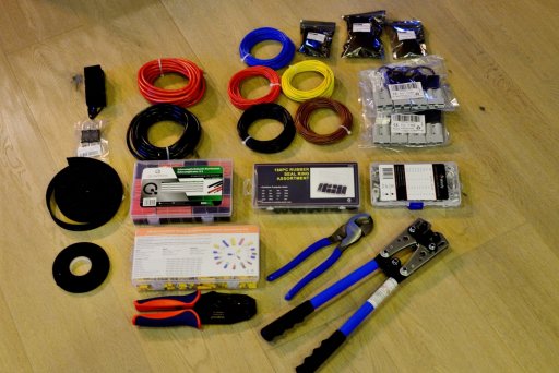

Was a little bit bored yesterday, so I began planning on my eletricl setup.
My car will get some additional lights for driving and camp site. While using it as daily driver, all of those electrical consumers will be supplied by starter battery.
While using the car on overland trips there will be added a freezer and the needed air compressor, for what I will switch to a 2nd battery and a booster with solar.
I will wire 2*25mm² supplies to the interior and fit an Anderson connector to it. Plus will get a 100A fuse. on daily driving this connector will lead to a 12V distributor. On Overland trips, the connector will lead to the battery system. From there on lead some 2nd wires to the consumers. But have a Look in my plans, I hope you can see how it is supposed to work.
Greets
Tobias

Hi Tobias,
This looks like some major upgrades for your new rig. Cool. How does it drive? Are you happy with the purchase of the Duster?

Hi Bjoern,
The road so far... it performs very well.
Wayyy less attitude than the Wrangler. You know what I mean.
Yes, it will be some major electric update. Hope it will work out as planned.

Well,
so far, the first delivery has arrived.
Wiring from engine bay to trunk can be done now.
Will post some pics when I do the work next weekend.

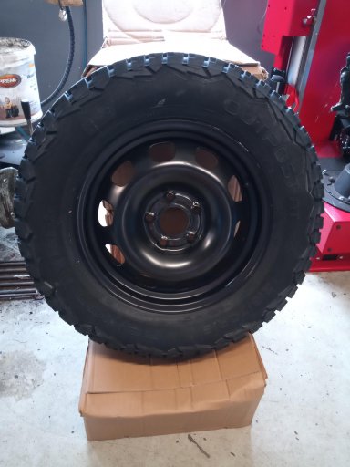

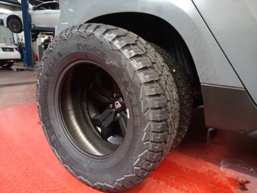

At the moment, I'm thinking about to remove the 17" alloy wheels now yes, and replace them to 16" factory steel rims with 215/70R16 Nokian Outpost AT instead of 215/65R16 or 215/60R17. This will increase hight about 1/2".
With the later installed lift kit, I will gain about 4,3cm / about 1.75" of lift in total. :relaxed:

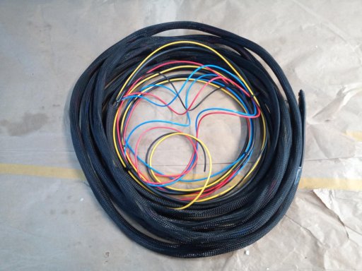

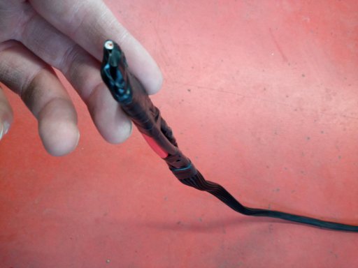

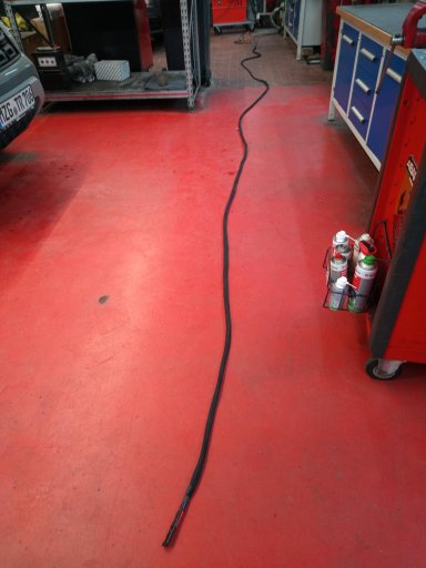

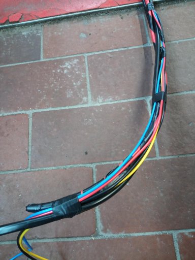

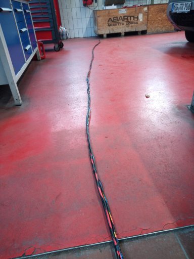

Yesterday I made some progress on the wiring.
I built the wiring harness, which houses now:
2x16mm² power supply AUX battery
4x2,5mm² power supply front beams
2x4mm² Solar Input

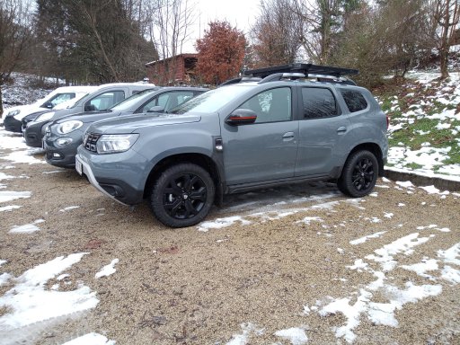

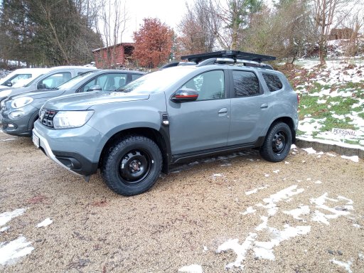

Today I changed my OEM wheels with 215/60R17 General Grabber AT3 for some good steel rims with 215/70R16.
Those tires ad a 1cm lift to the car and fit them much better than the 17".
More to come soon.
