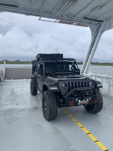

I wish I would have documented more of my build through the process, but I will try to catch up. Nothing extraordinary, but I did make some changes that were not bolt on parts that may help others. I will try to add on items as I can.
Here are a few photos of its current status. (Amazingly, I do not have any pictures prior to playing with it)
Current upgrades are:
