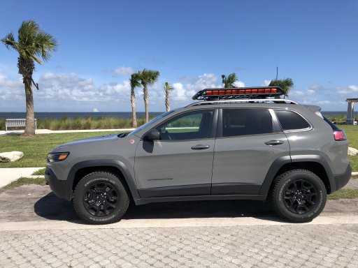

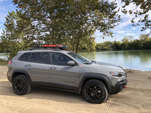

OK, on to the progress. Here it is on day 1, a stock 2019 Cherokee Trailhawk:
I don’t have a name for this one yet but I think it sort of looks like the shark from Jaws. I’m still kicking around some ideas. The roof rack was the first addition and I picked up some recovery boards (full post about the boards and mounts here) because getting stuck sucks. I‘ve done it in the past and don’t recommend it at all.

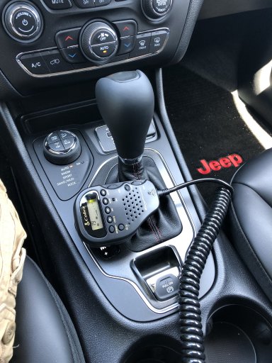

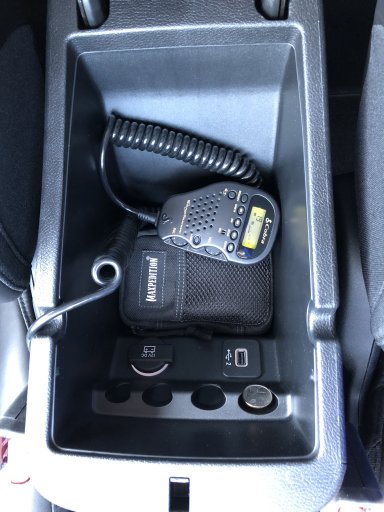

I also added a Cobra 75 WXST CB radio (full post here). Even with the renewed popularity of HAM and the recent surge in GMRS/FRS radios, CB is still the one most used. I mounted the base under the passenger seat and the CB can stay out of the way in the center console when not in use. I also keep a cheap Baofeng with a 12V adapter an a mag mount antenna in the truck in case I want to reach out a bit further. Lately I stick to DMR but, again, its nice to have options.
I had the front two windows tinted to match the rear ones. I don’t like limousine tint but I also don’t like slow-roasting on the interstate when the sun is on me. The back windows tested at 28% factory tint so the 35% I had put on matches almost perfectly. No problems seeing at night and I don’t turn medium well as the sun sets.

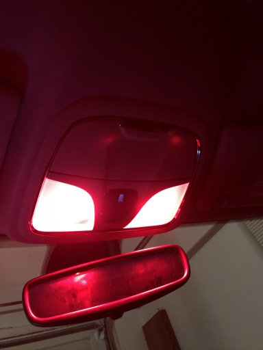

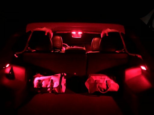

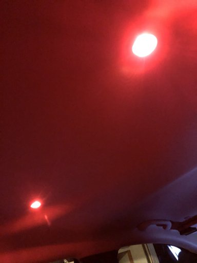

This week I finished changing the interior lights. I’m used to having a red dome light in my work vehicle to save my night vision so I always do it to my personal vehicle as well. Some people love it, some hate it. it works well for me. In my last rig I just changed out all the bulbs but in the Jeep, the front map lights and the rear cargo lights are incandescent while the rear passenger lights are single LEDs soldered on a circuit board. For those, I had to buy some red window tint and cover the lenses with two applications of the film. That ended up matching the LED bulbs I bought for the front and cargo areas perfectly. I left the white lights in the visor vanities and I left the white LED that shines down on the center console because it can be turned off. If I were to need super bright white light for anything, I also have an LED lantern on board. So, yet again, now I have options.
So here is how she sits right now. Still close to stock with some minor changes. I wanted to make this post so I would have a record of the changes/additions I’m making and I’ll try to keep it updated as I go.

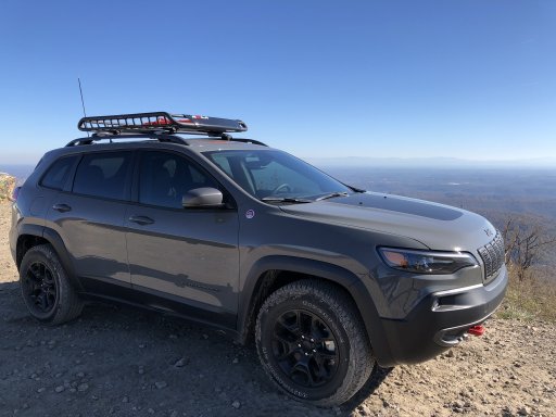

I thought my two mag mount antennas were going to be a temporary thing but they have ended up working so well that I don’t think I’m going to bother with permanent mounts. The mag mounts allow me to pull the antennas easily for parking garages or or the occasional car wash and it’s nice to be able to make the Jeep look stock when I don’t want to advertise expensive radio gear. Open the lift gate and both of them stow away with the spare tire. Easy! CB range is what it is; with the firestik I get 1-2 miles on the interstate which is plenty. The 2m/70cm antenna is a 1/2 wave so it more than adequate. I might actually pick up a 1/4 wave and see if that will work for me.
