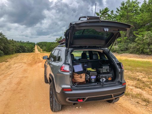

I wanted to be able to use multiple radios in the truck so I decided to wire up everything with PowerPole connectors under the passenger seat. This way, I can add or remove radios fairly easily in the future. Today’s project was to get the power routed. The Jeep has a handy grommet through the firewall for runnnig accessory wires but getting everything fished through the engine compartment was still a pain. I got everything buttoned up just before it started to snow so it was a pretty productive day. All that’s visible now is the Powerwere connector under the passenger seat.
I’ve got a new antenna mount for the rack on the way and should have coax for the antenna run by the time it gets here.

I got tired of having to take off the 2m/70cm antenna every time I wanted to park in the garage so I ended up buying a Comet B10 to use with repeaters around town and short distance car to car on trails. I also have a 1/2 wave that I keep in the back and I can switch it out if I need a little more range. I could have just put the B10 on the mag base but it’s short enough that it just barely clears the garage door when mounted on the rack. I’m going to leave the CB antenna on the mag mount base since I don’t use it as often.
I finally got everything fitted and hooked up and I think it looks pretty clean. I ended up repurposing an old Ram Mount for the FTM400xdr head which is mounted to a block of wood that fits in the front storage tray. The arm pivots out of the way so I stil have a good view of the 4WD controls when I need them. The base is mounted under the passenger seat with the CB.
Here is the Comet mounted to the rack before connecting the coax.
Powered up and ready to go.
