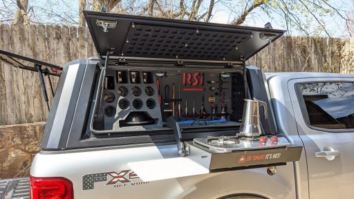

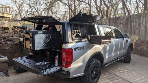

RSI Kitchen came in! Waiting on the stow away table and roof rack for it to show up.
Mounted up the ARB Elements fridge as well.
Trigger is getting new leaf springs to carry this new weight. Going with Old Man EMU springs rated for constant load of 660 lbs in the bed.

OME springs are ordered, but it may be a bit before they show up.
Roof rack and table for the RSI Smartcap are also out in the shipping nether still as well.

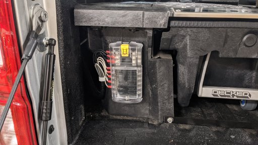

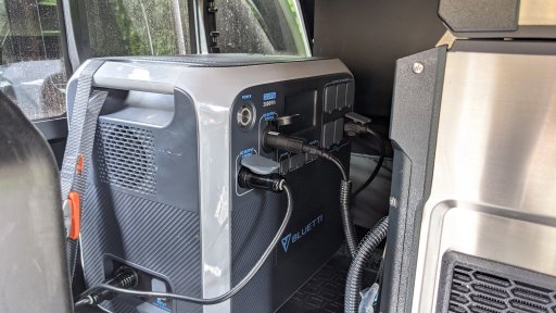

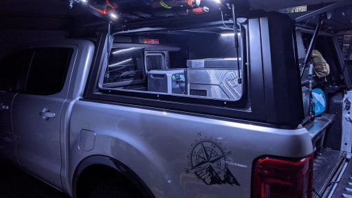

Shrockworks winch mount is expected mid May. I decided to go with a Bluetti AC200P with 400 watts solar for the power for the fridge etc. I wired an aux 12v charge circuit that is programmed to shut off power to the Bluetti anytime the truck is off to protect the starter battery.
In the meantime, I started working on the wiring for interior lights and the future exterior lighting. The lights are from Perth Diesel Performance and can be red or white. Switches in the cab are from Switch Pro's.
Ignore the crazy wiring in the red shot, as I was just testing the lights out.lol The fuse panel will be fed by the Bluetti's 25amp 12v output and runs everything in the back.

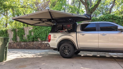

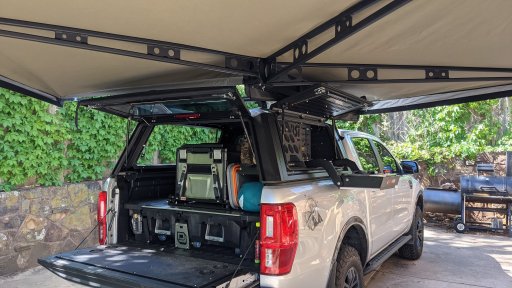

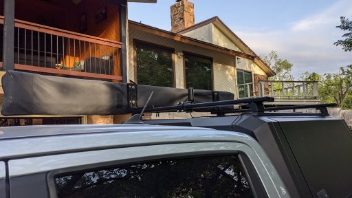

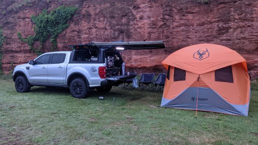

Still waiting on The RSI Table and platform rack to show up. In the meantime mounted some frontrunner load bars so I could get the awning up and in service. Spent the weekend out with it in light rain and winds, performed awesome! The Awning is the Bush Company 270 XT.

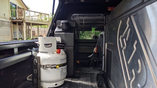

Finally mounted the propane and strapped down the water Jerry. I added the hose to the lifesaver jerry so that it can stay where it is and be used.

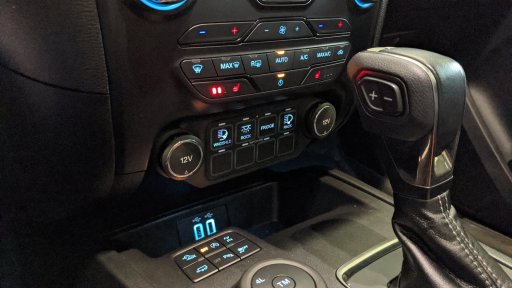

I wired a charging circuit from the switch pro's to keep the Bluetti's charge topped off while driving. The switch pro's module is programmable so I set up a circuit to turn on and off with the ignition automatically.

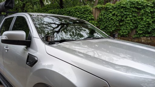

Mounted up a pair of Rigid dss lights on the windshield.

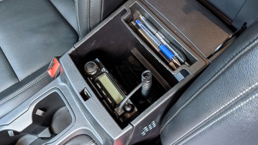

Found a hidden spot for the GMRS/FRS radio and mounted the antennae.

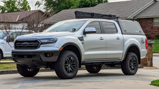

Installed the Old Man Emu springs this week. Pain in the butt. The poly bushings put up quite the fight and I had to modify the centering pin on the drivers side spring to accommodate the leveling shim.
The springs are part # EL121R which are for a constant 300kg (661 lbs) in the bed. The truck feels like there is nothing in/on the bed now!PXL_20210515_124623690.jpg
