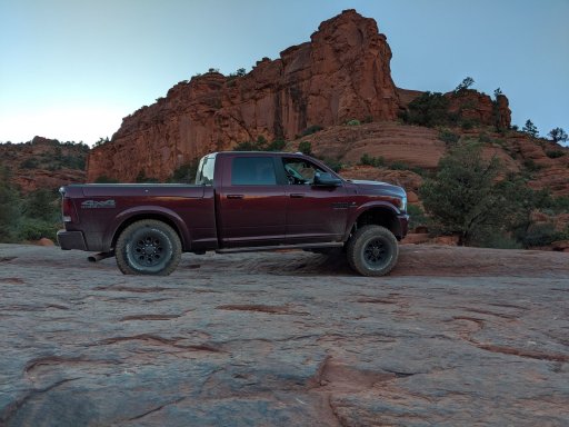

Starting my build on my 2018 Ram 2500. I got the truck about nine days ago and ran broken arrow trail in Sedona AZ this past sunday. I have a ton of parts but so far I have put on the Carli 3.25 back country lift, AEV wheels and 37 inch BFG k02 tires. Also used the AEV procal to flash the truck for the tire size so my speedo is correct. Currently working on installing the ARB twin air compressor and will post some pics tomorrow.View attachment 123399
