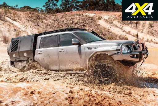

Dear >bnyc000< Your american Armada is REALLY equall to Y62 Nissan Patrol that Aussies modify into tough off-road vehicle.
As far as you have 4x4 model (from 60'ties avaiable 4x2 patrols) you have the same rough Patrol gen. Go for australian pages to buy some mods (lift, front locker, bumpers and long-range fuil tanks). Patrol Y62 is one of the rare "SUVs" where You may put 35" wheels on it without lifting (Y61 - most famous for its off-road must be lifted to 35" wheels). Y62 is so capable that you can carry crosswise full OZ TENT on back seats - no way to put it to LC200 toyota. Engines VK56 is one of the best V8s, well known in USA, reriable and not so thirsty. Gear-box RE5R05A is the same mounted into Y61 TB48 and can stand 1400 HP of power mods!!! It is very underestimated OVERLANDING VEHICLE.
nissan-armada-mountain-patrol-10-1542959319.jpgCustom-Nissan-Y62-Patrol-dual-cab-ute-mudcrossing.jpg
View attachment 137476View attachment 137477
The early Armadas are completely different from the Patrols. Up until 2016 they were built in Mississippi and based off of the Titan. Honestly that factory has lots of issues and while I think the design is sound, build quality is not what it could be. I would have no doubts about abusing a 2017 and up Armada as it is a Patrol with different badging. But it is worth noting, even the current Armada runs a different engine from the Patrol.
