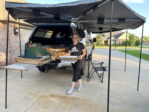

Well I broke down and ordered the Sherpa 56'' rails and feet for my shell and have an Overland Vehicle Systems awning enroute after watching the videos about them here. I will post once it is all here
