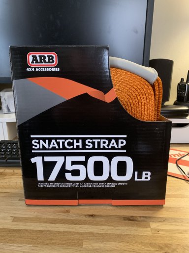

Looks like everything’s coming along great! Be careful with that snatch strap. It’s rating is heavy for the Outback so it’s not going to stretch as much as you’d want in a recovery situation. In short... take it easy.

HAHAHAHAHA I'm surprised she wasn't giving me the bird in my picture! Yeah, I was wondering about the snatch strap with the weight of my car. I had looked at Rhino tow/recovery strap but couldn't decide if that would be best. Still an option though as they are very affordable. I went with the ARB because for 1 the name and I just wanted to make sure that there was some stretch. The reviews I had read on the Rhino strap were mixed on if it would stretch or it wouldn't. What are you using? Also, you are running Rallitek overload springs on the back, correct? I am thinking of ordering the 0" front Ralliteks and 3/4" rear Rallitek springs. Hopefully the rear springs aren't to stiff like the King springs.

I started out with that same ARB snatch strap but after learning more about it from our Australian cousins I gave that to my brother for his Xterra. I replaced it with a...
Sidewinder Xtreme
Those convicts still consider that on the heavy side but I think its a good weight for the portly 5th gen haha. Another benefit is that kinetic ropes stretch more than straps. In the case of the two in question its 30% vs 20%.
They no longer make the front (essentially custom) or rear (Rallitek) springs I run but they are an 'overload' spring in the back. They do have a lower spring rate than Kings but they will still take time and abuse to settle in.

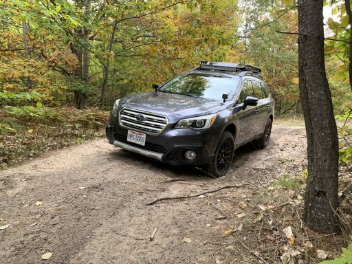

Some pics from late last fall on the Indian Gardens ORV route just north of Petoskey Michigan. New additions in the picture is the roof rack/basket and my deal of the year, a 30" Rigid E-series bar I scored for $50!
