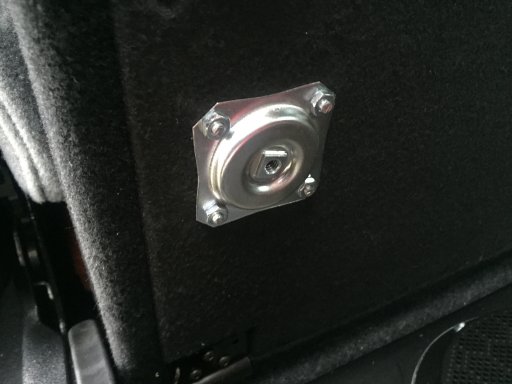

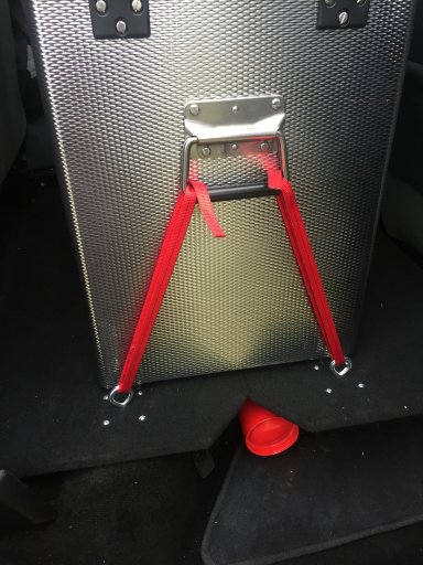

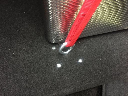

So I have almost completed the National Luna Fridge/Freezer tie down modification. I took the flat fold out bench under the rear seats and installed tie down points. From there I went back with the Eye-bolts and sewed straps that will be custom cut to length with velcro. This is what I have thus farView attachment 1259

That looks good man!! My only concern would be maybe putting a metal Plat on top as well to kinda sandwhich everything? Idk prolly just me cause I like overkill lol

This allows me the option to have the fridge in the back when I want, otherwise, I just fold up the factory installed bench, pull the seat down and no one knows the wiser.
Sent from my SAMSUNG-SM-G890A using Tapatalk
I hear what you are saying! I am in the process of trying to find washers for the 10x24 machine screws that I used. The way I see it, the force is being pulled from below so the plate below spreads the force out. The screws really only 'hold the bracket' in place. Would just like to spread some of the force out on the screw heads because what ever the material is I think it would be best. For now it works. I just have to get the wife to break out the sewing machine so I can cut to length and sew the velcro to the straps
