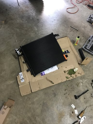

Well the summer heat is starting to linger around the southeast so what do most people do... turn on the AC in their vehicles... well mine didn't want to work. With a little bit of troubleshooting and searching I found my condenser had a hole in it. When I installed my front bumper last year I had to relocate the vacuum pump that was mounted on the frame. And after sometime the pump rubbed a hole/ crack into the condenser so I was lucky enough to experience changing that out. Looking back I probably would have taken the radiator out and it would have been so much easier but I wasn't prepared to change out the coolant.

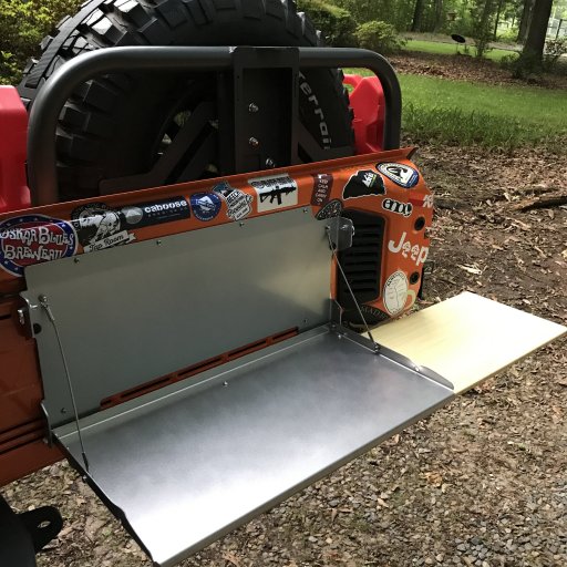

Installed my 5lb Propane tank and mount along with the Tailgate Table Tray.

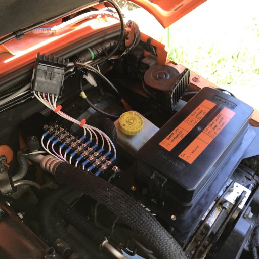

And currently I'm working on a relay panel to control all of the madness on the jeep. Like I said before working nights is tough so the electrical gets done little by little. But the birds nest of wires will be gone soon!
