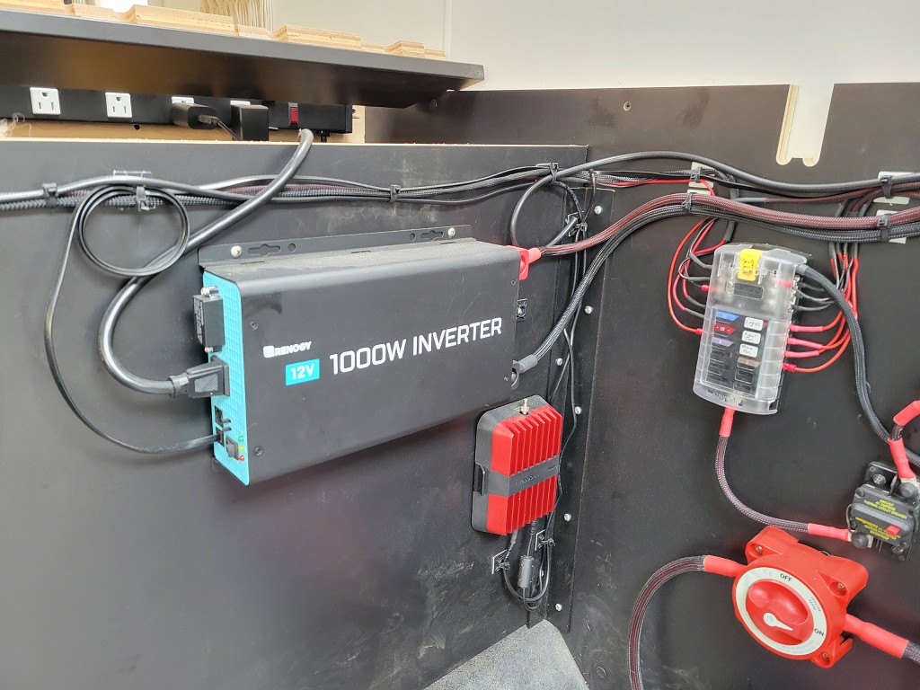

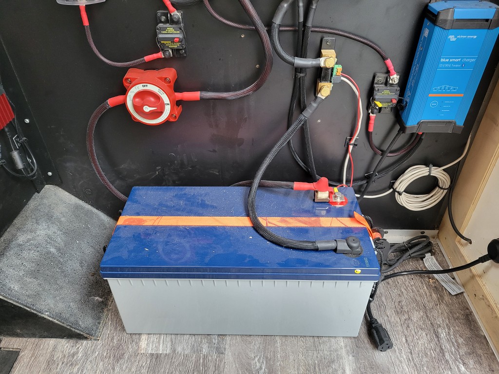

I'm jumping backwards a little since I don't think I ever posted the electrical setup in the rear of the van. We have two 100w solar panels on the roof with a 200Ah hybrid gel battery running everything. We're using a Victron MPPT 75/15 controller, Victron shunt, and Victron Blue Smart Charger. Several Blue Sea breakers, Blue Sea blocks, Blue Sea fuses, Blue Sea fuse panel, and Blue Sea Disconnect. We also have a Victron 1000w power inverter, and will have a Victron converter once we're hooked up to the alternator.

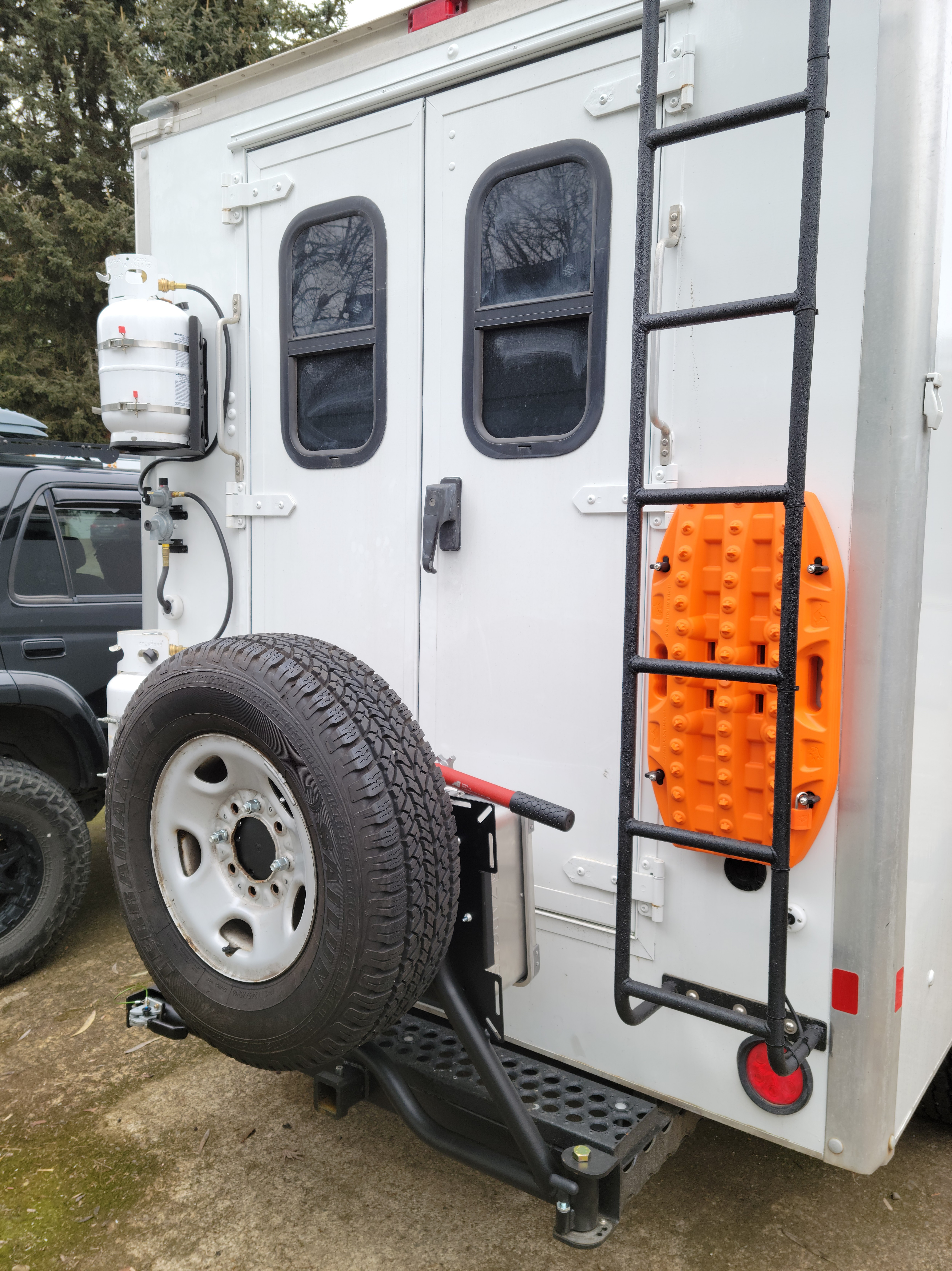

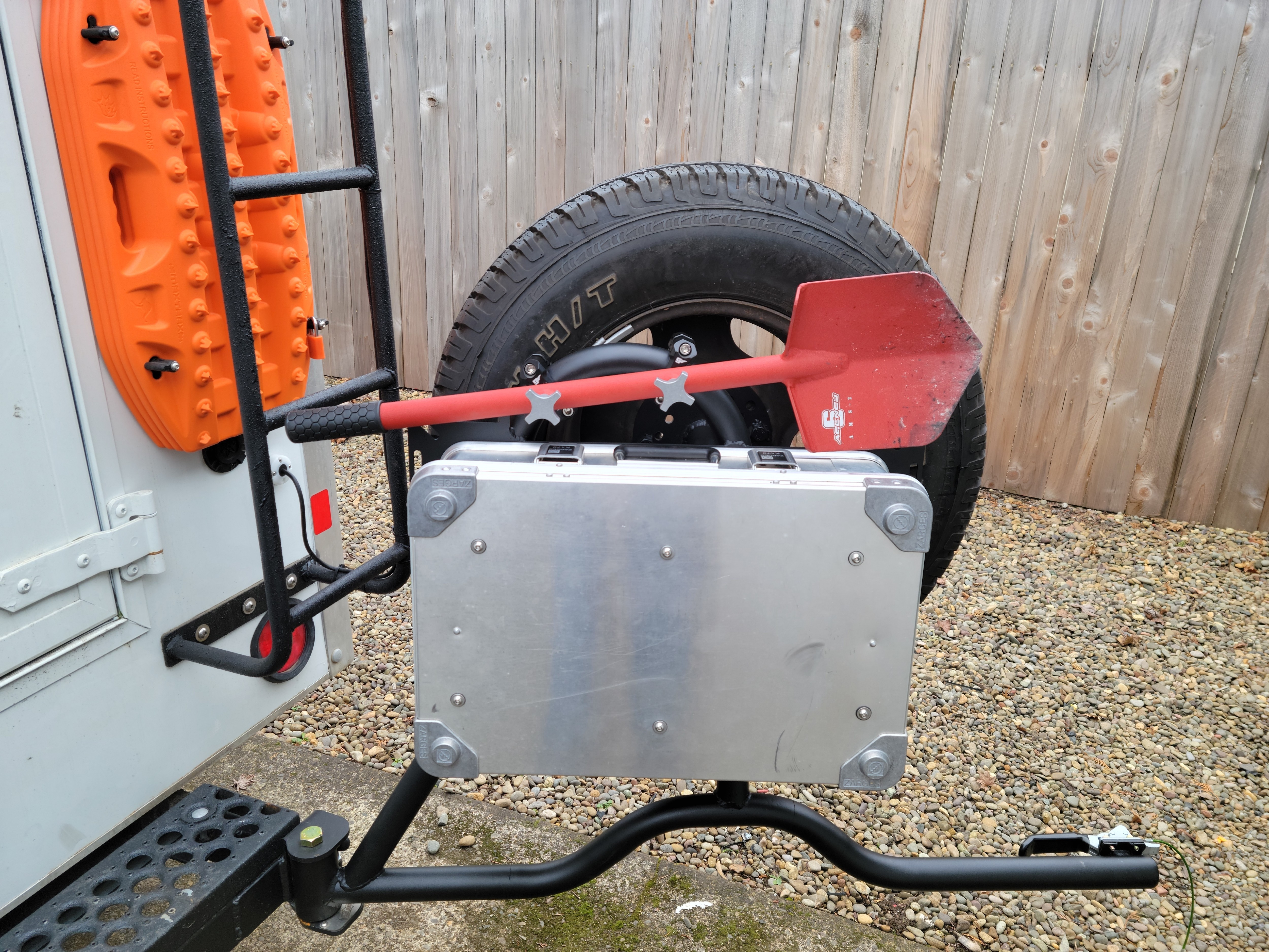

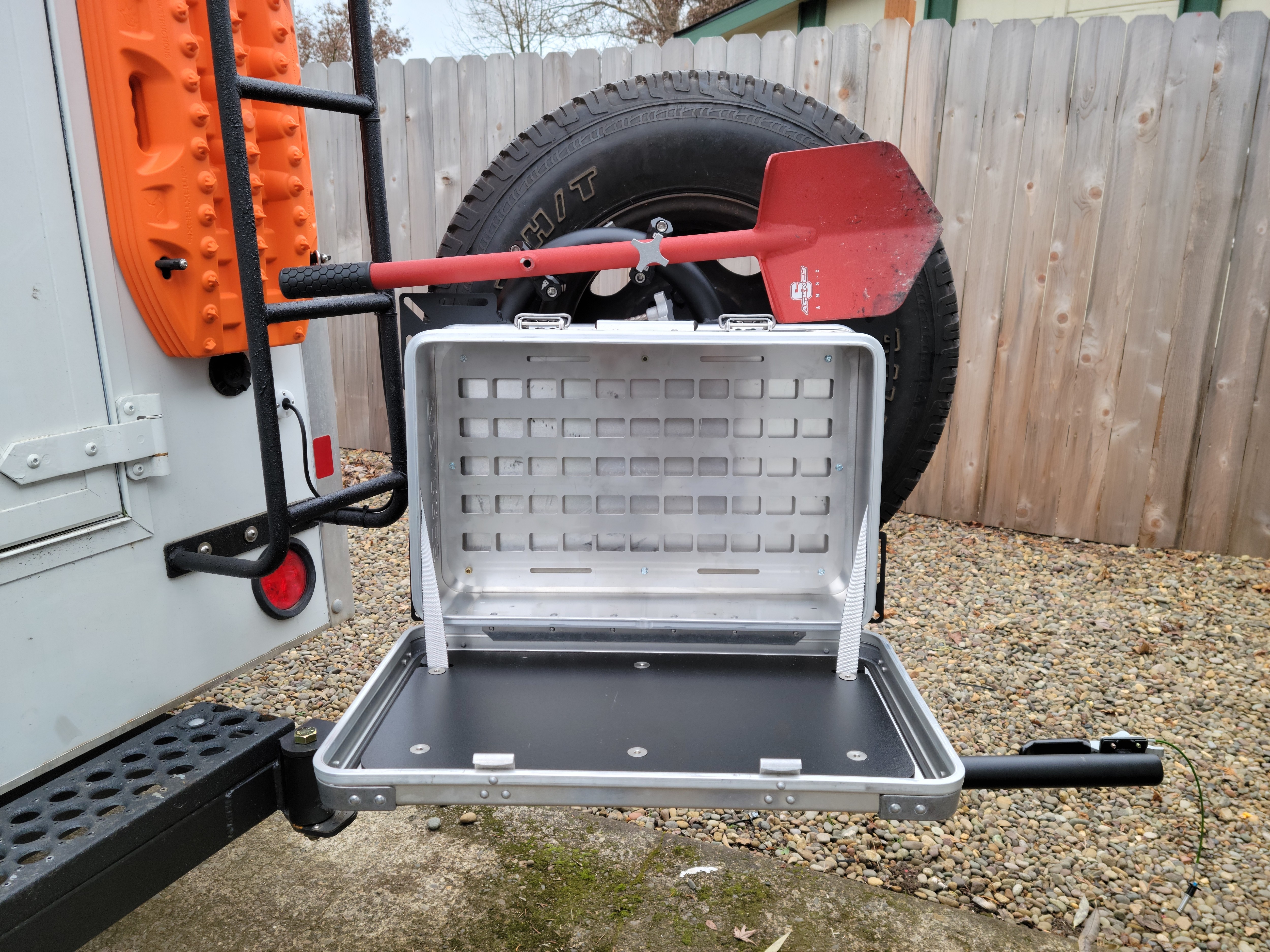

This morning I was able to finish up the rear bumper, and just in time for our upcoming trip tomorrow. The aluminum box was a bit of a last minute idea that'll double as a work center. I'll be able to store some item in this, and have a flat work space if needed.
