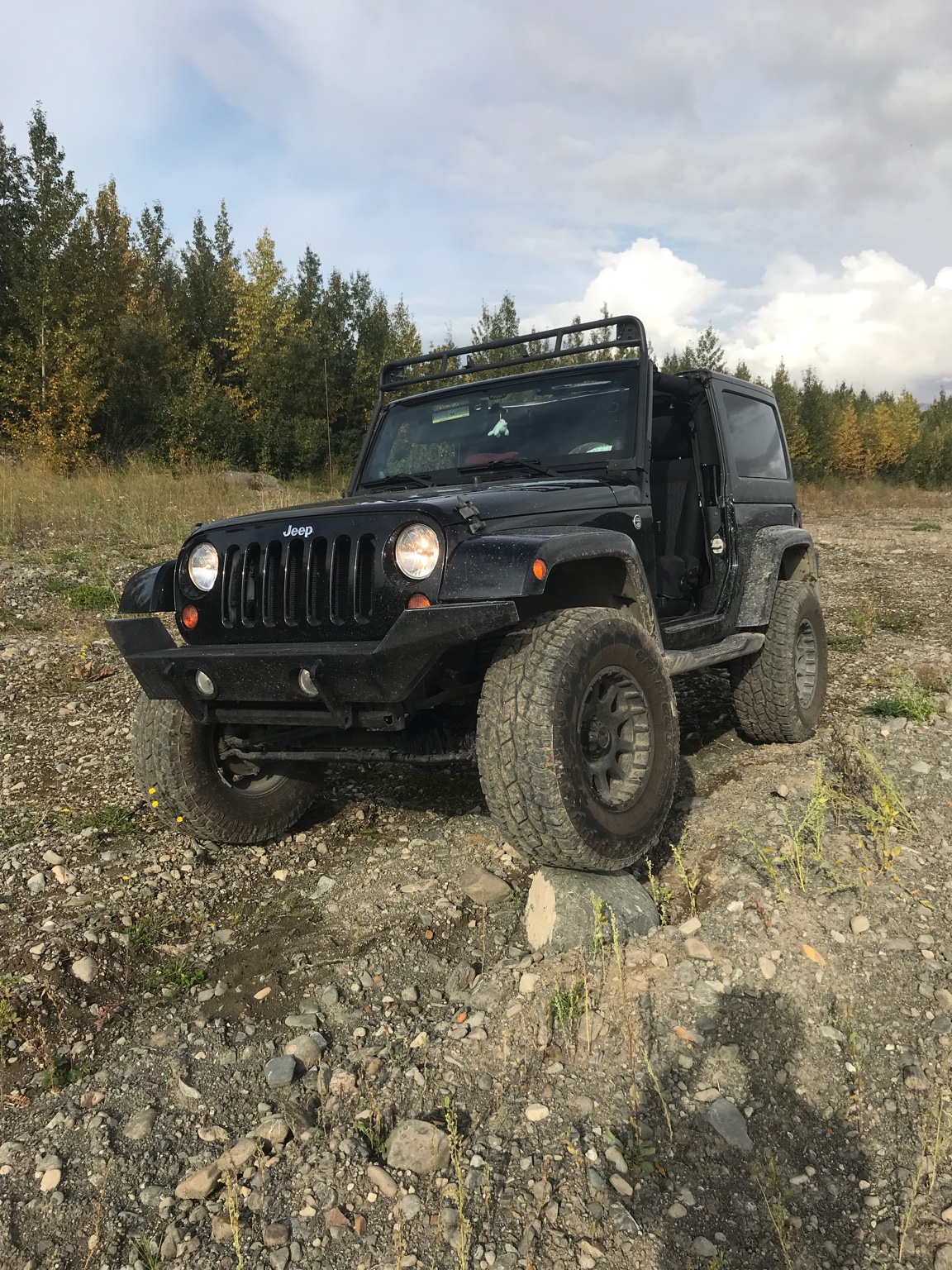

My Overland Rig is a 2012 Jeep Wrangler Sahara JK.
The build is a working progress. I will post what I have and then what I need/want for the build. So feel free to add anything you think I missed or would be helpful. Only doing things for the rig.
Currently-
35in x 17in rough country tires. W/ full spare
3in lift
2x 20L/5gal Scepter fuel cans
Custom steel front and rear bumpers
Rear-Dana 44 limited slip
Front-Dana 30
V6 3.6L 285 HP 260 ft-lbs
Need/want
Winch
Brush guard to protect winch
Snorkel
Fuel can mount
Air compressor
Lights, LED
Hi-jack w/mount
Roof top tent.
Steel, or reinforced sliders.
Note:food will be kept in a cooler with ice.
This rig is my daily driver, I mainly use it to get to and from work (I know, not practical) but I bought it for off-roading and that is its main purpose. The biggest downfall of the rig is MPG, I get about 12.7 in the city. Let me know what you think, any tips or tricks would be appreciated. I am new to overlanding, I will mostly likely only be doing weekend trips with the wife and kid till I get most of the stuff on my list that I need.

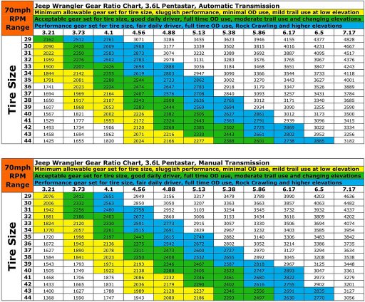

Here's another chart for you. Another thing to keep in mind is that the tire size on these charts is the measured size, not the advertised size, so make sure you know what your tires really are. Most 35s do not really have a 35" diameter. Also, like @BigSwole said, these are generalizations. If you're going to be adding a whole lot of weight you might not be very happy with a 4.56. On the other hand, if you're keeping it light and your 35s are really somewhere between 33" - 34", 4.10 might be just fine for you.
Your best bet is to find someone with a similar rig to yours and different gears and ask them to let you test drive it. If you're in a Jeep club that will be a good place to ask around.
View attachment 34890 View attachment 34891
