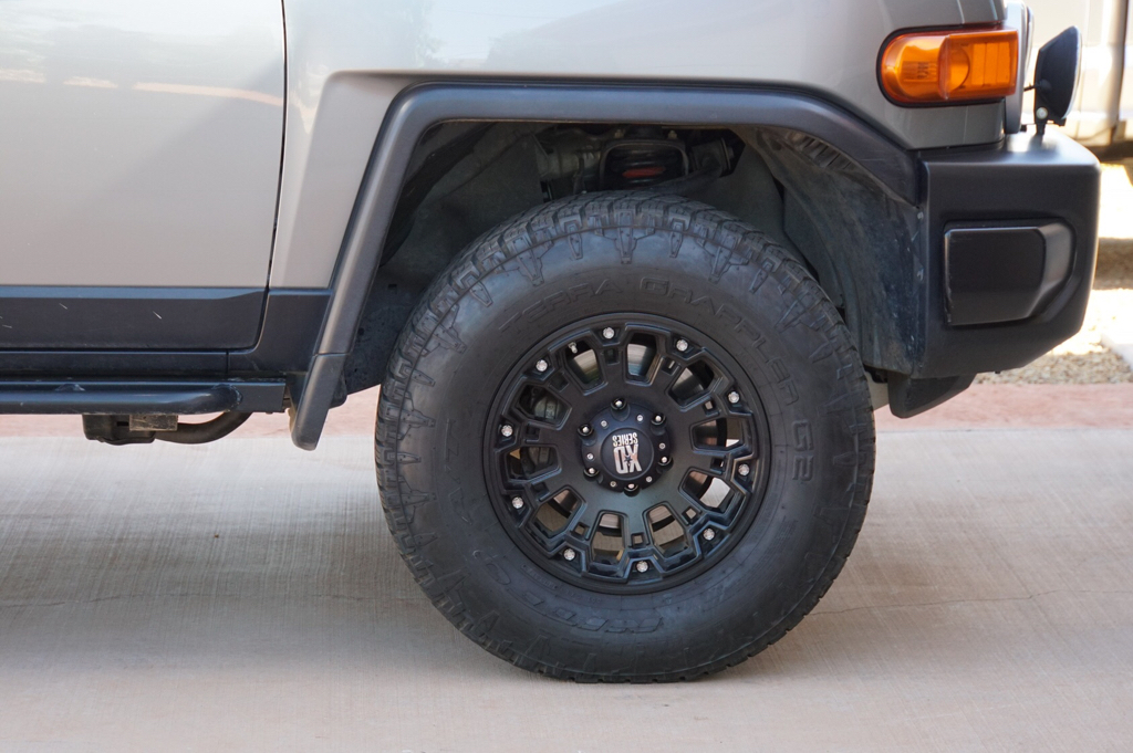

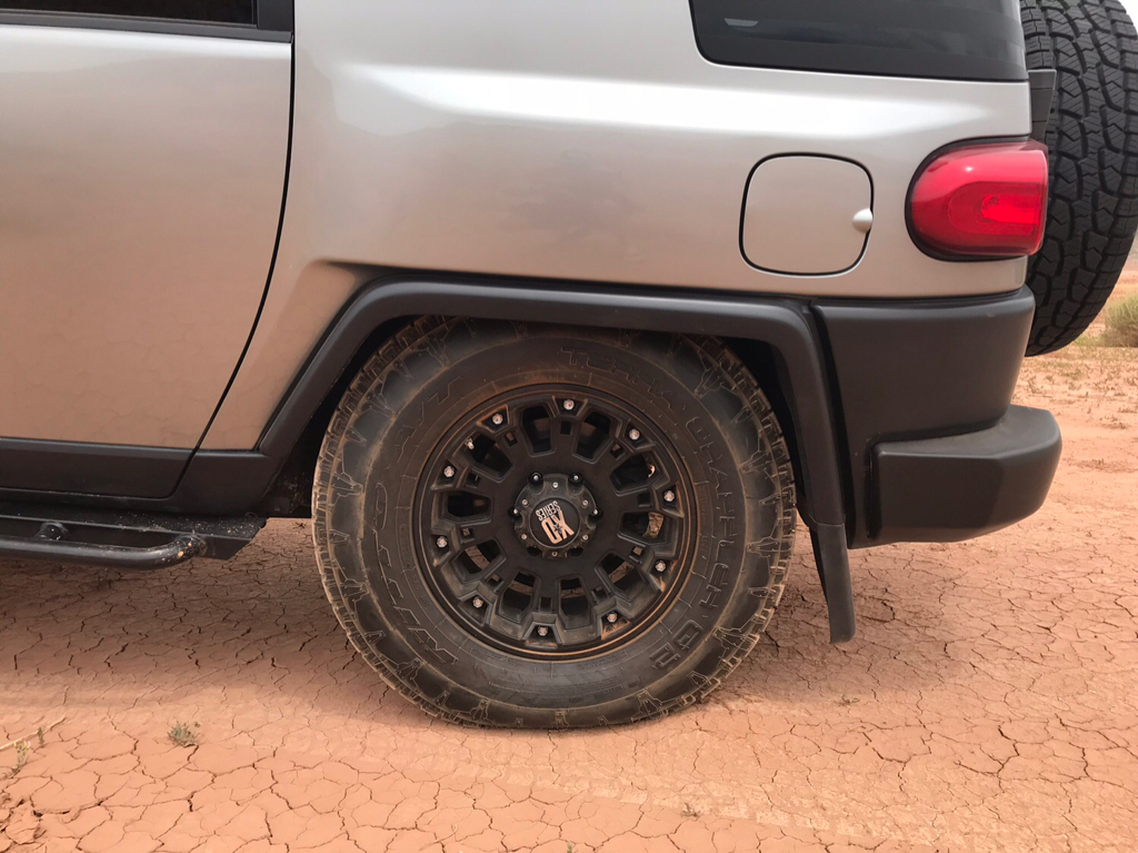

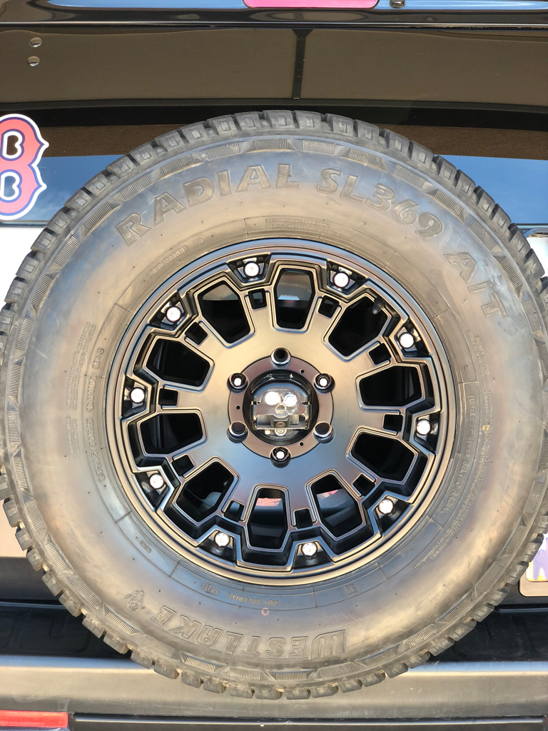

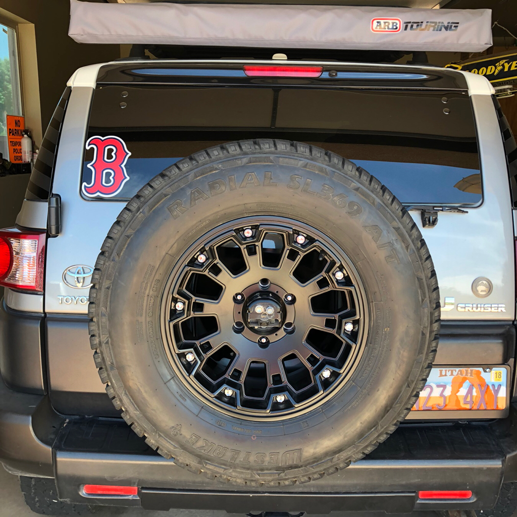

Picked up some used XD Series rims and Nitto Grappler G2’s. The rims are a little wider and have zero offset. Pushed the tires out just a little further that the factory rims did, but they still stuff into the fender OK. Now I’m on the hunt for a matching rim and tire for the spare, then I’ll sell the old set of 5.
SW_UT_FJ
Picked up a matching rim to complete the set of five. Mounted up one of the old Westlake tires as a spare. Next time I have to buy tires it’ll be a set of 5.

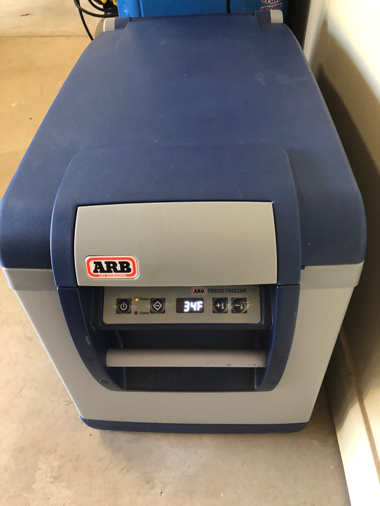

Picked up a ARB 50 Qt fridge used for a great price, south of $400. Now I’m thinking of picking up the insulated cover and exploring some mounting ideas for the FJ. I wasn’t really looking but the price was too good to pass up..
SW_UT_FJ

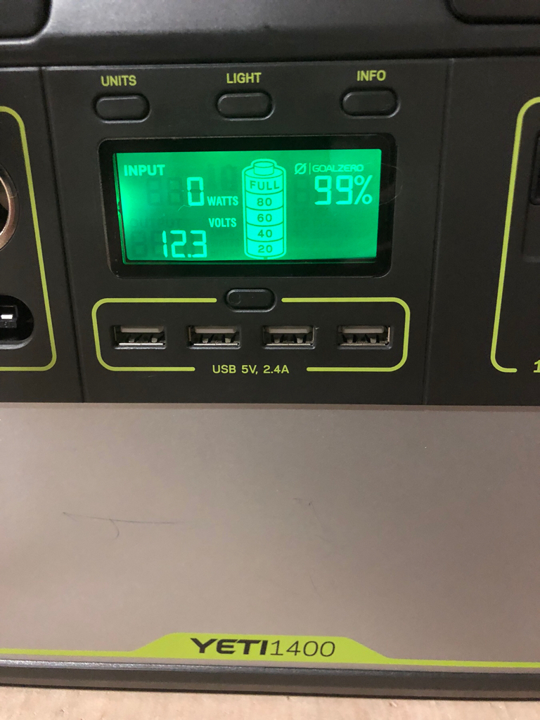

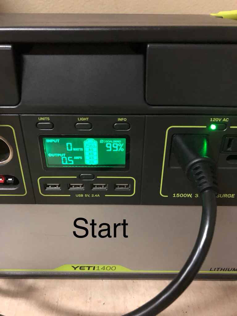

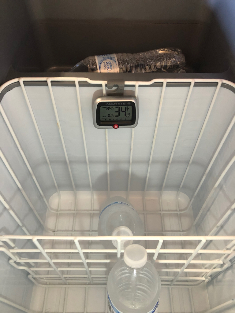

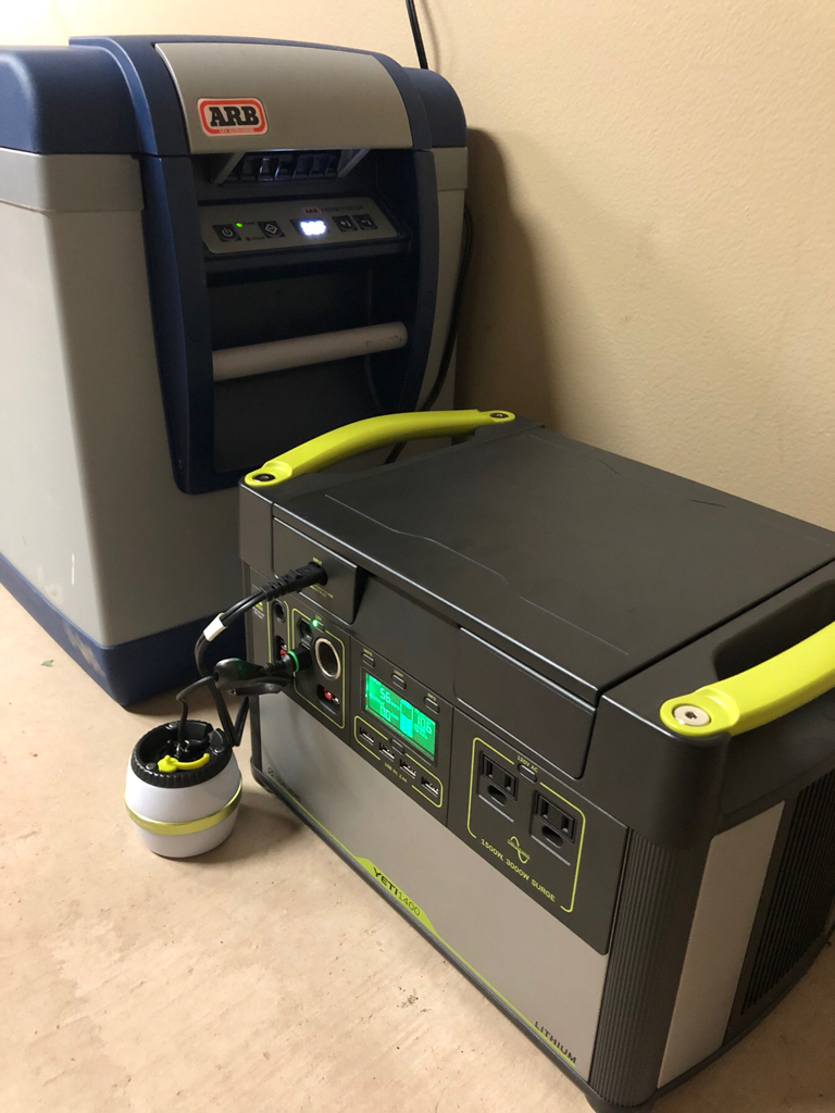

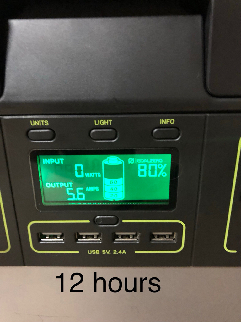

Picked up a Goal Zero Yeti 1400 Lithium V1. I ran a 24hour test with the ARB 50QT plugged into the AC inverter side of the Yeti. ( I realize the fridge is DC native and would run more efficiently on DC...future test). With the fridge already running and cold (34 degrees) it used 20% per 12 hours. This was set up in my garage, no charge input to the Yeti, ambient temps 100 - 78 degrees. Not very scientific, just a quick geeky test that makes me smile. I’ll run another DC based test soon in the FJ.

That's good to know. Did you open and close the fridge at all to simulate use?
SW_UT_FJ
No I didn’t, that’s a great idea for a real world test! I’ve ordered the outside cover for the ARB, mostly for protection from scratches. I’m curious if it’ll add much insulation factor to the fridge as well?

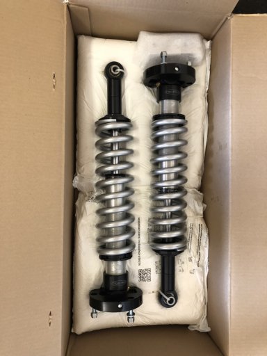

Swapped out the Rancho’s for Radflo 2.0’s. The three hours between NASCAR and the World Series game was plenty of time..(go Red Sox)IMG_2076.JPGIMG_2077.JPGIMG_2083.JPGIMG_2082.JPG
Next I’ll buy the wrench and crank a little more lift, and get rid of the .25 inch drivers side lean.

The Radflo spanner wrench and sway bar relocation kit arrived..
Easy install on the sway bar kit.
Adjusted the front for one additional inch of lift, the stance is getting closer to how I want it...maybe just a bit higher in the front..[emoji3]

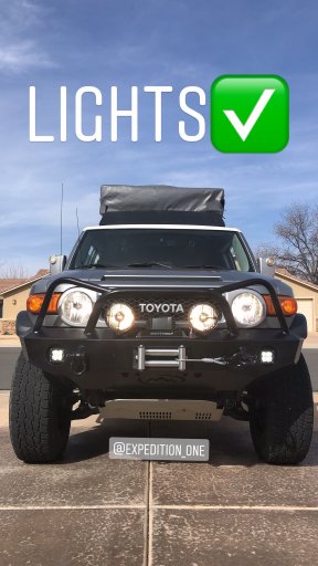

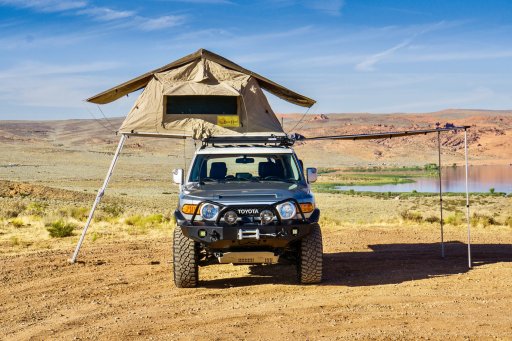

Installed Expedition One bumpers and a Smittybilt Winch. I’m very happy with the easy install and amazing customer service from Exp1. Future mods include swapping the Hellas for some larger round LED lights, and possibly exchanging the steel cable on the winch for synthetic rope.

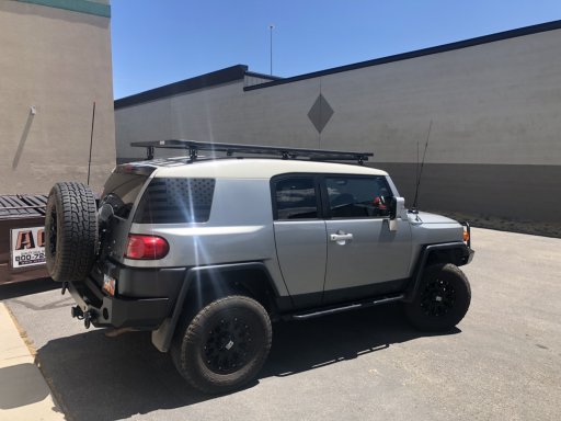

After researching roof racks I decided to go with an Eezi-Awn K9 flat rack, 87x49. I drove to SLC and bought from Equipt Expedition Outfitters. IMG_4971.JPGIMG_4969.JPG

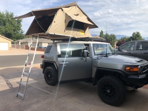

I picked up an Eezi-Awn 1600 series 3 tent. I’m impressed with the quality of everything on the tent. IMG_5201.JPGIMG_5203.JPG
Wife approves[emoji3]
