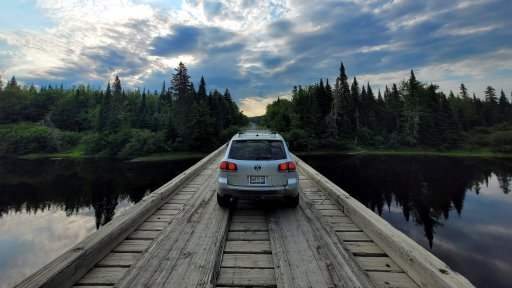

this is my 2010 VW Touareg TDI 3.0 V6 diesel. I bought this to replace my daily a 2010 golf TDI (mildly built malone stage 2
with a 1.5" lift) I needed more room for outdoor adventures. I haven't had it long and it will be a slow build budget permitting.
all I have done so far is have it tuned, - malone stage 2 (280hp 434lbs torque) and deleted the backseat so I can use it as a
pickup truck (muddy dog hauler, tools and lumber hauler, camper etc). this thing is a tank weighing in about 5600-5800lbs. it is a
4xmotion vs the usual vw 4motion awd system. that means it has a hi/lo transfer case and locking center diff (v8 treg's got
air suspension, a center and rear locker and some v10 tdi got a front, center and rear locker). with my current setup I get
28.5mpg highway 23mpg city if I keep it at 75mph or less, I also wanted this model because it has a tow rating of 7700lbs.
my treg came riding on 275/40/20 and they did well on a first trip up the golden road in maine. thankfully I just picked up 6 used 17" porsche
cayenne wheels last week and the 5 - 245/70/17 toyo open country load e tires come today in the mail...hooray!

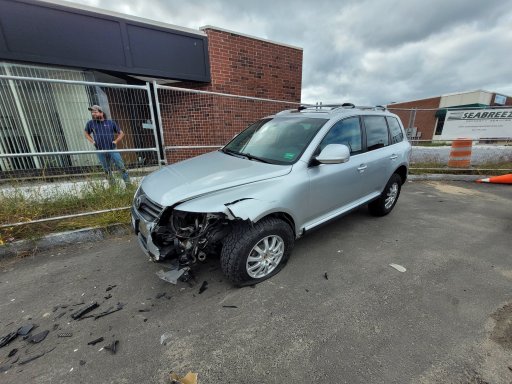

fastest build ever! I'm already done :wink:
my VW treg was taken out by a driver exiting the parking lot on the opposite side of the street last week.
she panicked floored it and drove straight into my parked touareg...wtf.
I'm pretty bummed but it isn't the end of the world. I also wasn't inside my VW at time of impact thankfully.
I'm already working on plan b...jumping platforms and restarting a slow build with a different automaker.
I've been an audi/vw guy for years, I think it just might be time for a change.

That sucks. But good that you have not been in the rig while it happened and got hurt. I hope everyone involved is well.

Sorry to hear, glad you weren't in there. Curious what ideas you are kickin' around. V10 treg?! I kid - I do want to drive one someone day.

My jeep almost got rear-ended and I totally lost it... Good that there where to many people around.
I'm sorry for you, but glad you will start something new.

Make sure you buy it back. that drive line will make a nice swap.

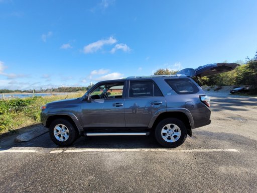

change of plans, touareg dream now dashed but overlanding/winter camping dream back on track. I bit the bullet and replaced the treg today. I am picking up a new to me one owner clean carfax 2015 toyota SR5 4runner for $1800 under book and 105k miles tomorrow. it has a hi/lo transfer case and rear locker which was why I bought my 2010 treg tdi. I will miss the touareg and tdi aspect more than you know but I still have the lifted stage two golf tdi on tiguan springs to play with that gets over twice the mileage that this 4runner gets...hooray.

Sorry about the VW. It looked great with those wheels and tires. But! Congrats on the 4Runner!
I am curious though... how do you know it has a locker? Is it aftermarket? ARB?
I have a 2015 4Runner SR5 and they did NOT come with a locker, even as an option.
it doesn't have a locker, I thought I saw the switch for it but I mistook it the DAC button. no worries I will be looking into an aftermarket solution when funds are good again :wink:
You should have an A-TRAC button, though. A locker is certainly nice to have, but A-TRAC works amazingly well on its own. Sorry to hear about the VW but glad to see you have a new platform to build out!
Good deal. I just wanted to make sure someone didn't try and scam you or something.
I'm sure you've already been searching but if you want a night and day difference in drivability, look at swapping the shocks for Bilstein 5100s.
I swear by them now after feeling how much the nose dive and roll went away (which I'm sure you've discovered). Also, it's a relatively cheap and reliable upgrade. I set the spring mounts at 1.75" in the front and added a 1.5" spring space for the rear. You can also set them at stock height or +0.85".
excellent info, thanks! I am super well versed in VW/Audi stuff. Toyota is just another matrix to learn and a little easier than german auto to figure out...german auto are definitely hard nut to crack.
