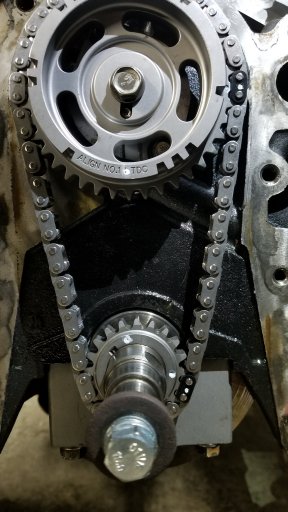

Well the company "Over the Top Offroad" that did the engine swap was full up with projects and couldn't fit me in. They are a Great Company. Its been 10 days at this point (Engine swap took 12 hours) so back to my house and the main code I looked at was P0016. Cam shaft and crankshaft not in sync. So all new sensors installed again although they were already new for initial install. Bye the way all the pictures in this post are part of the almost 1 Gig of pictures and video to document the problems with this build and 505's quality. Started it up and still throwing codes, running and clanging. What could it be..................... NO it couldn't be that they installed the timing chain and gear set wrong could it? YEP! Off by 1 tooth. The dots are supposed to line up on chain and appose each other on the gears. Timing cover gasket #3, rent a gear puller, reset the gear and chain in correct spot.20171025_054552.jpg
