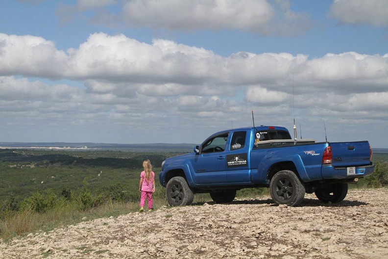

North Padre Island (60 miles south of the nearest road.) BuddiPole in the bed.

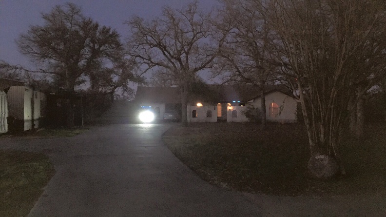

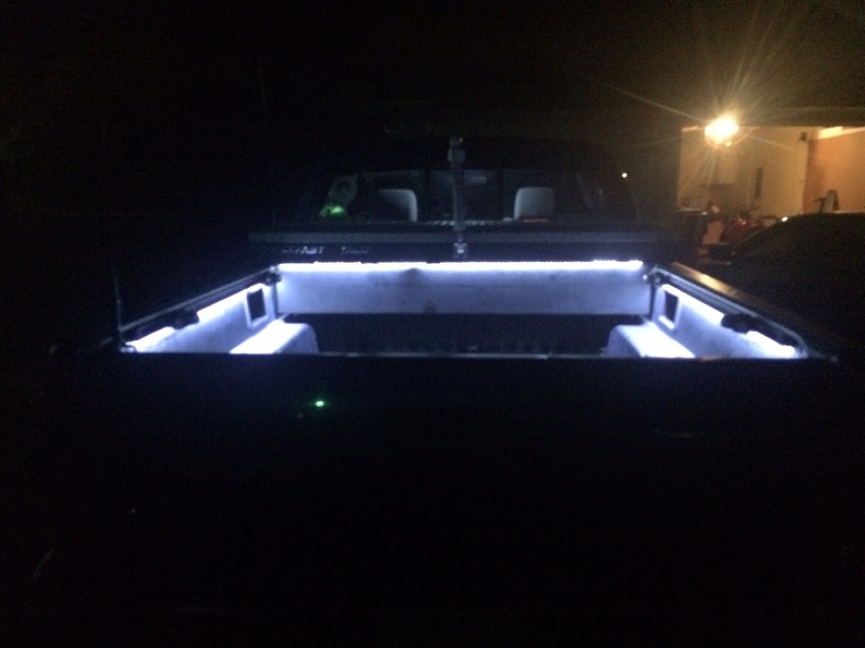

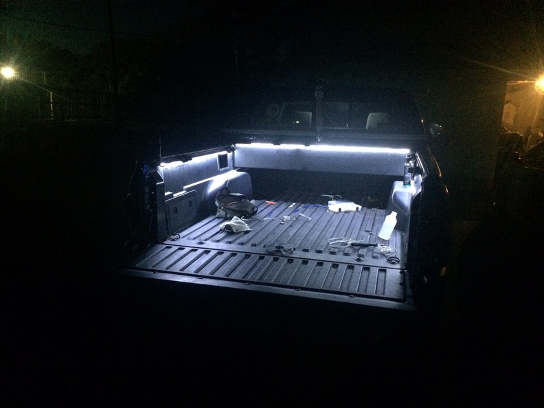

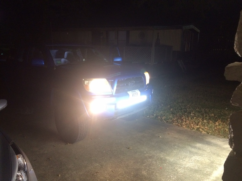

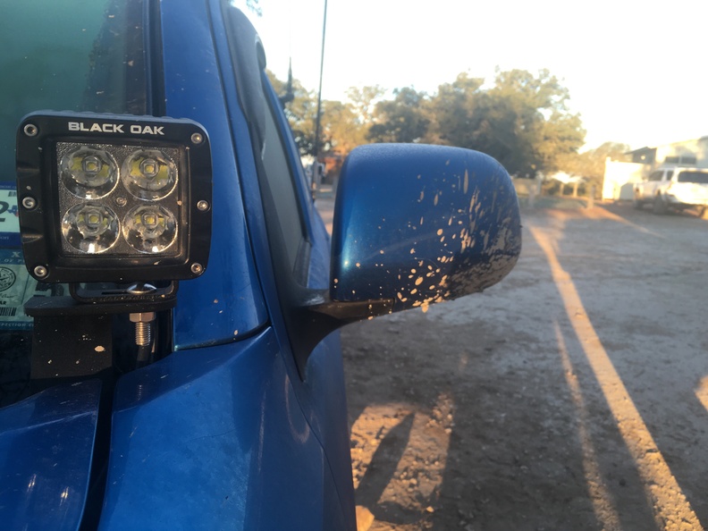

Installed a bunch of lights on my truck, with several more coming.
Under Hood Anti Dark.
This replaced one screw holding the headlight, and activates the LEDs when the hood is opened.
Truck Bed Anti Dark. -- (comes on with the interior dome lamp)
Rear Camp/Reverse LED Pods

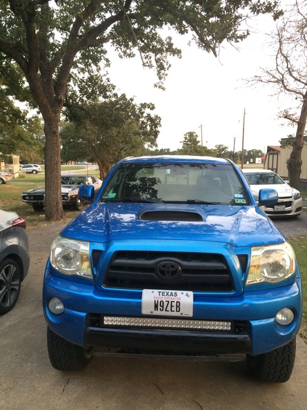

Front 30" LED Light Bar

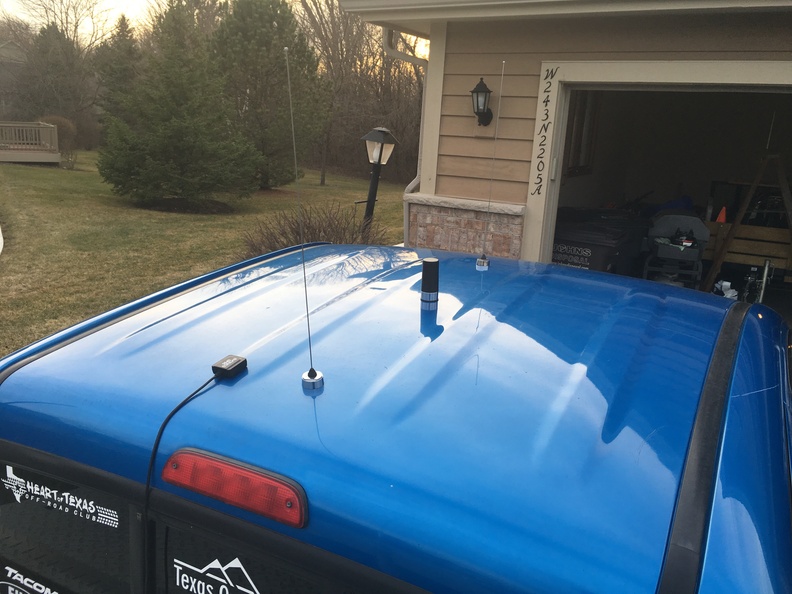

New Antennas, replacing previous antennas.
I replaced the two Comet SBB-1 dual band antennas with three mono-band antennas.
Back Wall of the truck. MFJ Duplexer to separate the single VHF/UHF output from my Kenwood TM-D700 into separate VHF and UHF antennas
The roof of the truck. I drilled three 3/4" holes to mount NMO Mounts through the roof. The front and rear antennas are Larsen 1/4 wave 2m. The Center is a PCTEL Maxrad phantom 70cm antenna
