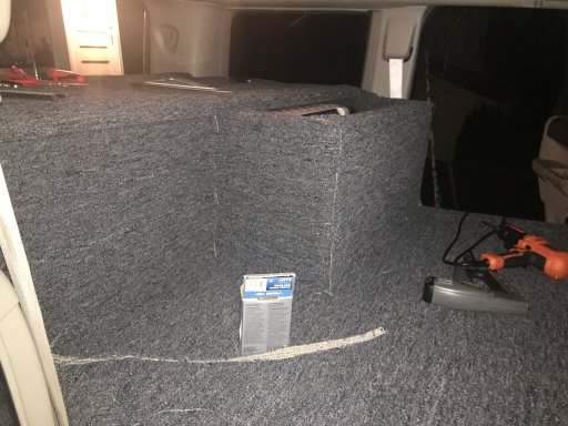

I recently purchased the 95L Dometic dual zone fridge/freezer. It didn't fit quite right.
So, the solution is to take out the second row of seats so it fits, right? Hopefully I'll have some video of the install. But here are some pictures of the process.
I haven't built the drawers yet, the lid to cover the front of the fridge, and there are still some finishing touches to be completed...
So much more space without the second row too!
