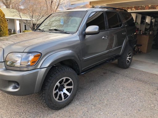

2005 Tree Build aka "The General"
Boort
Those black pieces on the glass are the radio antenna, OEM.
I am (for now) doing a platform with space underneath for storage containers. (looking from hatch in). Plus I will tuck space around platform. It will be about 13" tall inside where storage is going, no drawers per say, storage containers which I will pull out as needed, mainly tools and stuff...
If any of that makes sense...LOL

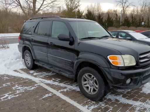

I figured it was some kind of antenna but had not noticed one stock. Dad's 2004 tree still uses the automatic extending antenna on the passenger's side front fender. Generally works fine but like the rear hatch release prone to stop working and expensive to fix.

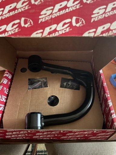

Completed the Brake Upgrade: Lexus milled calipers and power stop rotors and pads up front and all power stop in the rear. Love it.
Braided Steel brake lines also....(gx460 big brake kit, SPC uppers, Crown brake lines.)
She stops soooo much better now.
