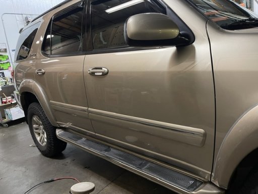

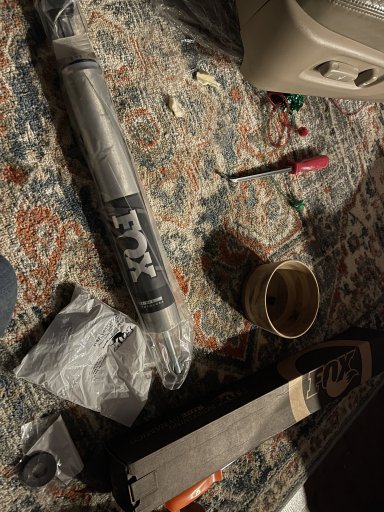

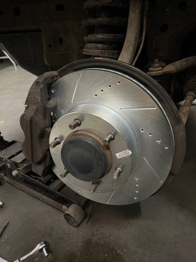

Place I bought it from claimed to have put new brakes on it and they did but just the pads so it started developing a shake when hitting the brakes from warping the rotors . Hope these help , took me a couple extra days to get them on when I could do a proper break in procedure without someone calling the cops thinking I’m drunk .8CE88FFA-2B87-46F0-9293-A72F5998DED8.jpeg

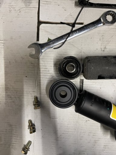

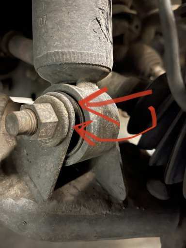

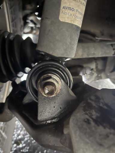

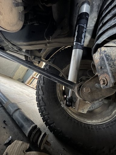

looks like one of my new struts is almost shot already . I didn’t quite pay attention when I installed them but it looks like one side has a different lower bushing than the other guess I need to pop this one out send it in for warranty. F0A59847-3485-4728-B014-892F65AEE829.jpeg

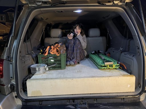

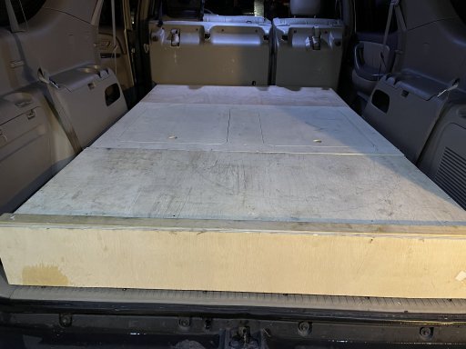

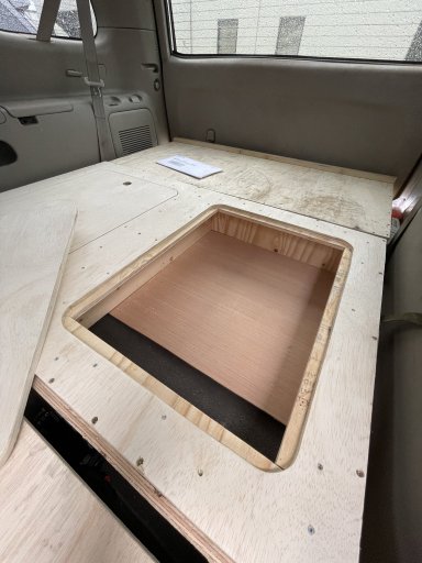

Version 2.0 of the sleeping platform, took a couple inches off the drawer , added the drawer sliders and made a longer front platform with a piano hinge that’s wedged in super tight eliminating the need for a second support underneath. Next up is carpet and tie down points . The kiddo approves 75BC3F07-9945-483D-9169-A7703A037812.jpeg23BE3CB5-192E-4DFD-9D9A-B6CD7AF8D8CA.jpeg
