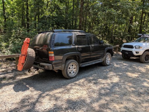

Last November I bought a soccer mom's old Tahoe with 171000 miles, so still somewhat young. Fully loaded with stuff I'll never use, like the DVD player. I bought it for overlanding/towing because I wanna do some more autocross/track days with my Sonic and, due to its mods, is near unbearable on the interstate for more than 30mins.

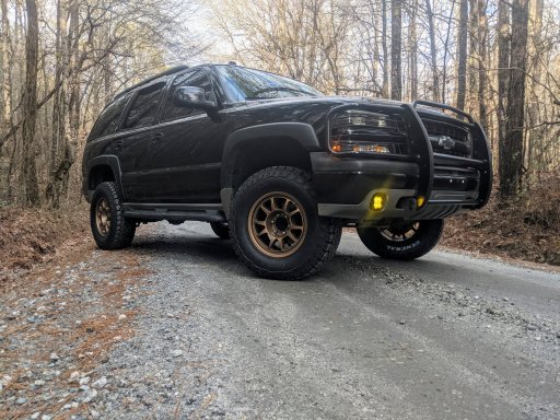

First thing I did was put on some 265/70/17 General Grabber ATX to replace the KO2's that had turned to basically drag slicks
Next was new headlights as a Christmas gift and some cheapo led pods

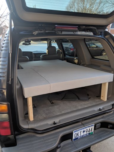

Next was the interior bed platform with a notch cut out to get in and out. Still need some kind of mattress pad

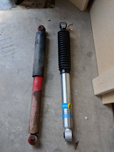

Most recently was a trailer brake controller, new radio (spoiled by Bluetooth in the other car), and Bilstein 5100s all the way around
