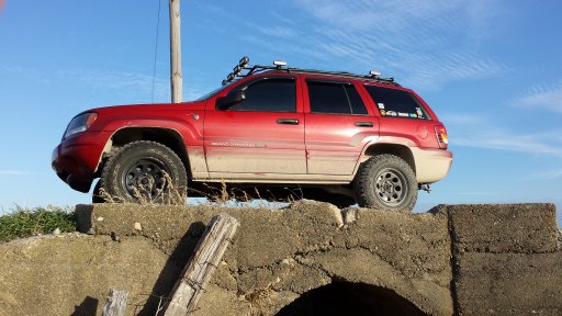

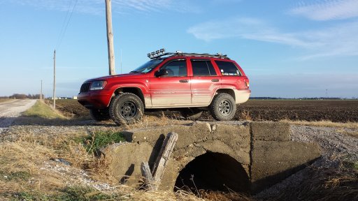

Just some updated pics from the drive to family Thanksgiving yesterday.. Found some fun dirt/gravel back roads.
