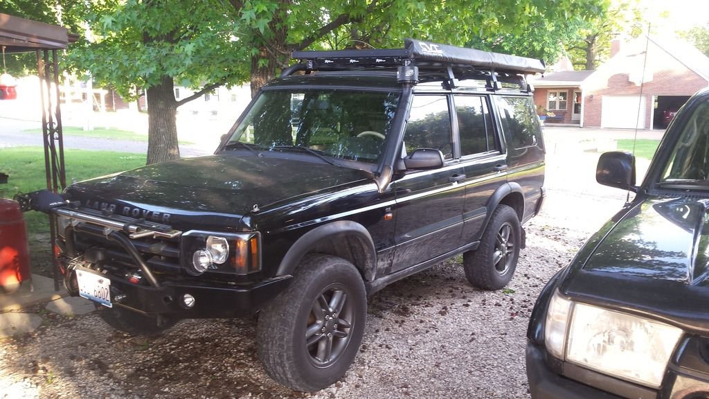

With the switches being a bust this past weekend I decided to move on. I was able to install front and rear differential skids, and the Southdown snorkel. My wife only asked for a couple things on the Rover, and having a snorkel was one of them. I didn't get pictures of the differential skids yet, but I will get some tonight.
Below are a couple pictures of the snorkel. I didn't take any pictures of the install since it was pretty much a guessing game. To say the Southdown snorkel had instructions would be an exaggeration. It came with a template for the cutout, but that's about it. I had to do some searching for Google images to get everything figured out. In the end I think it turned out pretty good. I still need to seal it up just a little around fender fitting.
For those of you familiar with the Southdown snorkel you'll notice something different about this one. I worked with Southdown before purchasing the snorkel to see what they could come up with for an elbow. I didn't want to run their typical snorkel end, and wanted to use a Donaldson Top Spin filter instead. They were able to bend, and stretch an end fitting for me that allowed me to mount the Top Spin filter vertically.
