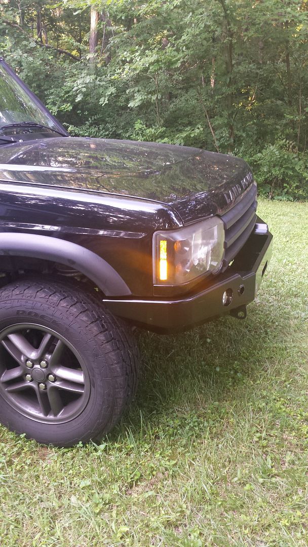

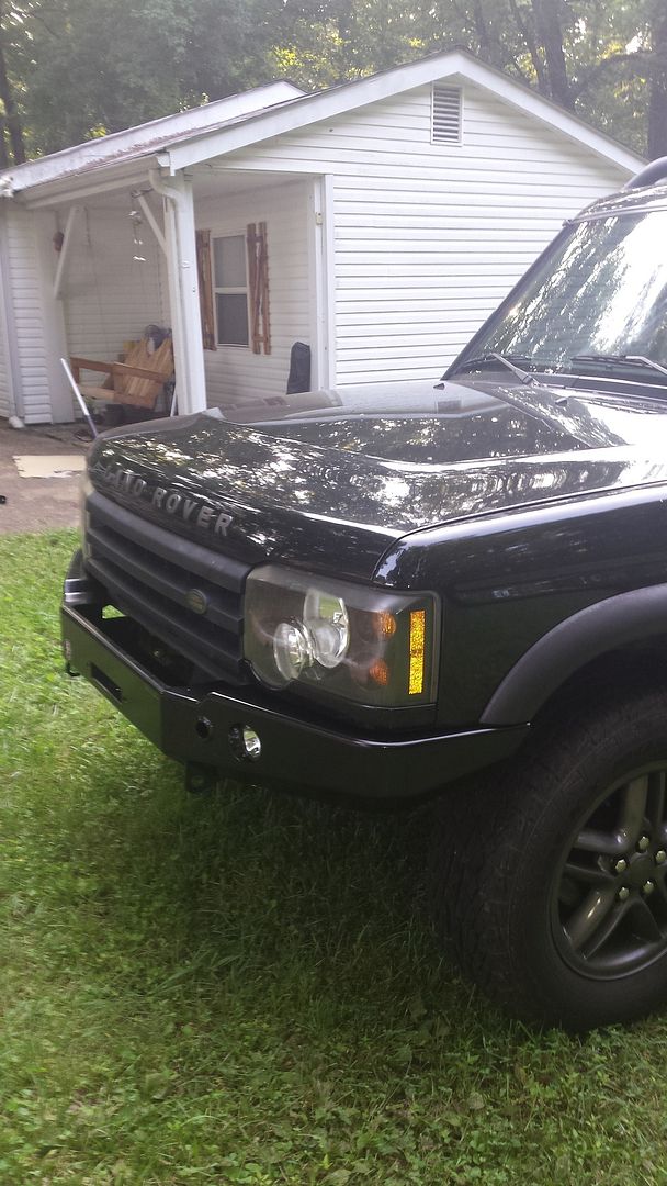

Just before Christmas we hit a deer on the way home from the inlaws. That meant time to order a new bumper from the UK. We had this in less the 7 days, and couldn't be happier with it.
This is a First Four Offroad bumper from the UK.

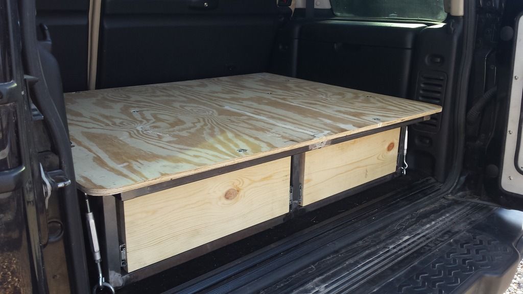

I'm started this project last week by taking some measures, and figuring out the best height. These drawer system is 9" in total height, and 33" deep. It's going to have one full length drawer, a half length drawer, and one storage compartment. The frame is made from 1x1x.065 DOM box tubing. I guess the weight for this to be around 25 pounds.
The top of the platform has a 3" lip to cover up the ARB drawer handles.
We had some good weather today, and I finally had some time to work on my own stuff. I spent the majority of the day today building the rear section of our platform. Tomorrow is supposed to be even nicer, and I plan on finishing the drawer fronts, and the top of the platform.
Made some progress today, and I'm very had with how this one turned out.
Added some turnbuckles in the front, and the back to make sure this doesn't shift.
Got the deck on, and the drawers installed.
Since I'm going to be laminating the top I decided to recess the t-nuts flush with the top of the deck.
Two 28" long drawers side by side that are about 7" high.
I was able to get the finishing touches done today. I added a matte black formica to the top, and drawer fronts. I also trimmed up the edging with some black plastic t-molding. For the drawer fronts I was able to use the ARB Safari drawer locks that I purchased awhile back.

Love that bumper. I was looking at one of those before I sold my DII. We have similar tastes in wheel colour, too. Nice job on the drawer system and tailgate, too.

I'll have to show this to the wife. She's been eyeing a roof rack like that for quite some time now, but I keep telling her no. The bumper is pretty nice, and I'm glad that we went that route. I've since welded a small hoop on the front to give it a little more protection.
