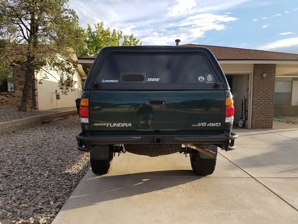

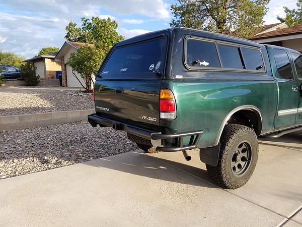

Squirrel

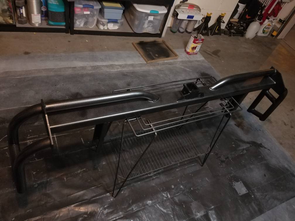

Rear bumper should hopefully be ready by this weekend. It's starting to look pretty!
I want to do a dual swing out setup but this is completely uncharted territory for me. Any ideas or suggestions on how to do this would be greatly appreciated!

N8CRWLR
OB Member #5037
Call Scotty at Addicted Offroad and he will help you with all the questions that you need to know.

Haha great recommendation! Scotty is actually the one who built these bumpers :)
Thanks for the links! I appreciate it!

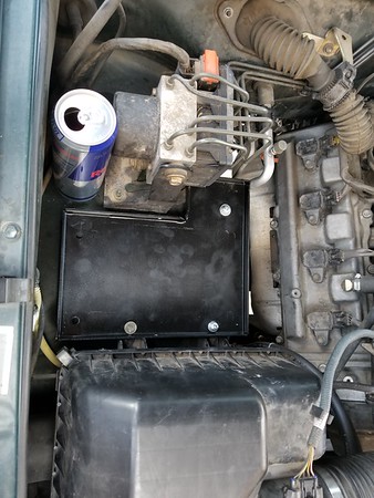

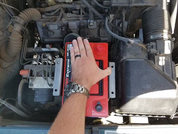

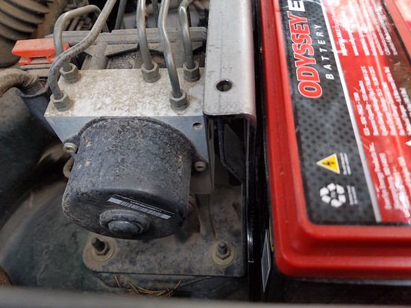

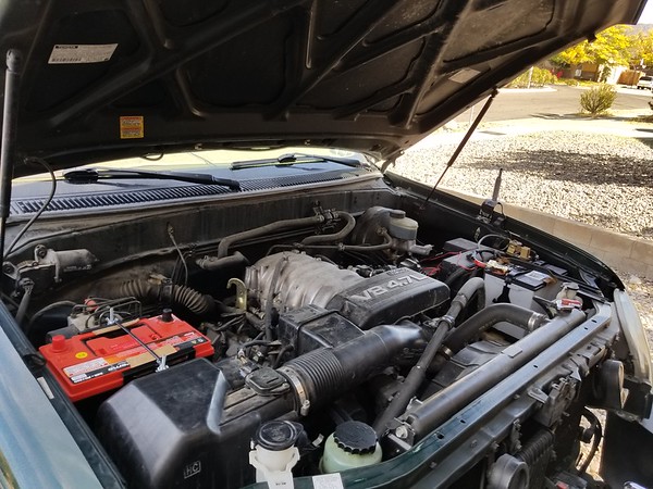

Squirrel
I need some input and opinions on my dual battery setup.
I was able to fit the secondary battery and tray in the engine compartment but it's a TIGHT fit. I already have to relocate my power steering reservoir to make it fit but I can free up some space if I move my ABS module (which I really don't want to mess with, hardlines are not as forgiving as a hose).
I'm wondering if a small battery box located in the bed might be an easier/better option. Some things I also want to consider before I decide:
- I have a 4x4 sPod that I need to install with this setup.
- I would really like to get a solar setup connected to the aux battery in the future.
- We're using the truck bed to sleep in (2 adults and a child) so space is at a premium. Although having a box with plugs built right in could be very handy.
Thoughts and opinions?
OB Member #5037

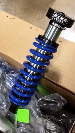

Squirrel
So this happened today :) pretty much like Christmas!!
They turned out a little different than I was expecting but I'm perfectly fine with them!

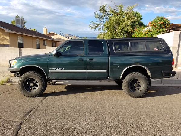

Squirrel
Yesterday the truck went in to Toyota for some recall work, one of which were getting the lower ball joints replaced. Today I got the additional leafs from Deaver put into the packs, installed the shackle flips, removed the 1" blocks, and put the U-bolt flip kit on. Just have to install the Timbrens now.
After all was said and done I gained 2.5" of lift in the back. Now I have some pretty noticeable rake but the King's will be going in soon and should level everything out. I'm looking forward to being level again and also getting an alignment.

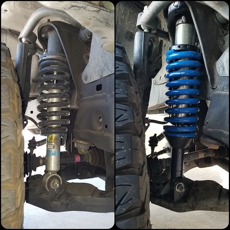

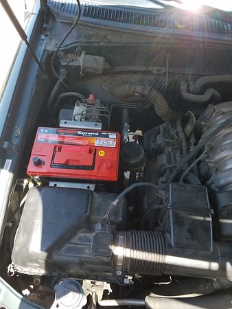

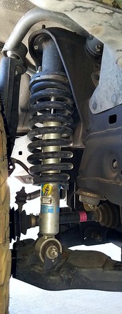

Squirrel
Been a little while since I've updated. Since my last post I've gotten a fair amount done. The Kings have been installed in the front, new steering rack, finally remembered to install my Timbrens, installed the CB, and just today I installed my secondary battery (still need to do all the wiring). Picture time.
