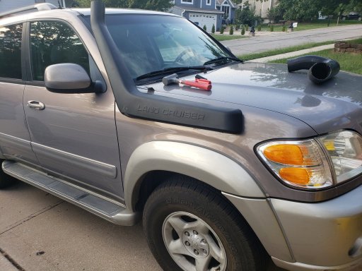

Got the snorkel 98% installed, replaced the rack and pinion, TRE, sway bar links, power steering lines and a wheel speed sensor, front struts/coils, installed a 3" lift and an awning. Started measuring and designing for the sleep platform/kitchen pull out. Next up are some new wheels and either 33's or 35's.

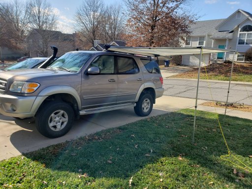

Updates... got a new awning in November, very nice addition. Installed the lift, replaced the rack and pinion (nasty messy PITA job)
Got some traction pads too, and a chinesium air compressor, now I am an overlander...

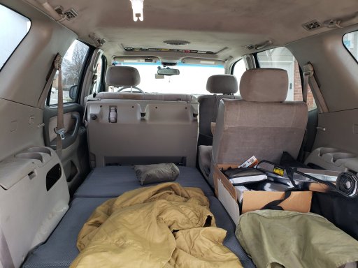

For Christmas my wife bought a set of heat shields, window covers for all the windows in the Sequoia. Makes the interior darker, cooler (or warmer) and gives some privacy. I also ordered a mattress that should perfectly occupy the 60 portion of the 60/40 middle row. I am torn on whether I build a 12" tall platform to sleep on that goes over the middle row when folded down. Or try the mattress on the floor. The extra head room would be nice. No matter what I am building a pull out galley on the narrow side. Working for a company that sells drawer slides, hinges, plywood etc I am over loaded with options. More on that to come.

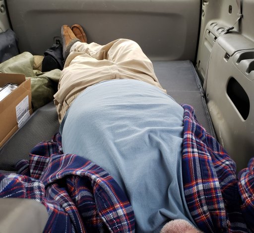

Mattress is good to go.
I wish I had a few more inches of length with the middle row folded up, but as I am over 6' tall I will deal with this as it is. I don't think it will be worth doing a raised platform as I have 6" over my head when sitting and it is plenty of space to get dressed etc. I do plan to do a flat floor, to cover the seat latch points for the 3rd row and make the slide out galley more stable. More to come.
