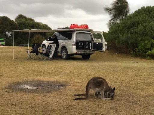

Looks great ! I know you'll enjoy it. For comparison here's what we did on ours:
· Dobinson’s heavy duty suspension with 50 mm lift
· Mile Marker Scout 8000 winch
· Safari Snorkel
· ARB transmission breather
· Custom-built roof rack with sand flag mount and rear light
· Sand flag
· UHF radio with front-mounted aerial
· Second spare wheel & tyre (6 all-terrain tyres on 6 alloy rims ) - standard rims, 265/65-17
· Extra fuel tanks on roof rack (100 L capacity, temporarily 120 L for the Simpson Desert)
· Built-in folding frame for bed with Americana de Colchones purpose-built mattress
· Fire extinguisher and mounting
· Storage system below bed and bedside storage
· Dometic 35 L refrigerator/freezer
· Custom-built storage lockers on slides
· 44 L Frontrunner potable water tank
· Window covers with ventilation adjustment
· Mosquito nets for all windows and rear opening
· Leather map pockets for both front seats
· Camera storage system
· Side and rear awnings (Dobinson’s and ARB)
· Compressor
· Second (hydraulic) jack
· Rescue kit with tow slings, shackles
· ARB sand ladders (recovery rmaps) and shovel
· ARB Airlocker folding chairs
· Redcamp folding table
