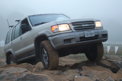

Great build! I actually joined this forum from reading your thread. I have a 2000 Trooper on a 2” OME lift and I’m slowly building it into an overland rig :grin:
Thanks. There is a lot more to come. Big plans for this little rig.
Hey Chris, great build!! I didnt see a whole lot of pics of the trooper however. What are you future plans?
I got ball joint spacers and 1 inch coil spacers and I will get my lift up to an even 3 inches. I want to get a taller narrower tire when the time comes and need to make a little space and also ensure im not stressing the cv joints when I get the front cranked up so I'm going to install the spacers and do a UBJ flip on the uppers before I crank the torsion bars up that final inch.
I really want to get or build a winch bumper. Probably build since it will be cheaper than buying the ARB and having it shipped. Then I'm planning to build a rear bumper with a swing out on the 1/3 short door side (keeping the tire mounted to the door, its closer to the rig keeping weight closer to over the axel, that way) The swing out will be for my rotopax and jack. Getting a RTT so need to build a roof rack to support it (my rig has the factory threaded mounting points on the roof for 3 cross bars so that should be sufficient). Those are my plans for this year into next year.
