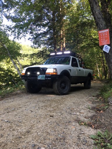

View attachment 39153 View attachment 39152 View attachment 39151 Hey guys! I’m new here and thought I would start off my introducing my truck and showing a few pictures! Always looking for ideas on how to improve it so if you have any ideas please let me know!
My truck is a 2002 Fx4 Ford Ranger with a 4” superlift, I ditched the torsion bars and did a coilover conversion with Fox emulsion coilovers. I also installed a set of BTF uniball upper control arms and running a set of 33x12.50r15 BFG Ko2’s. The truck has factory 4.10 gears and Torsen LSD in the rear. I built a rear swing out spare tire carrier bumper and have a 2 gallon Daystar cam can on the spare. I welded on a set of trail gear rock sliders for protection!
I’m currently exploring my options as far as a roof top tent / awning set up and if I want to run a camper shell or a bed rack set up.
I love this truck! I have a similar truck I am building. How did you build that bumper? Looks like a simple single piece of steel tubing?
