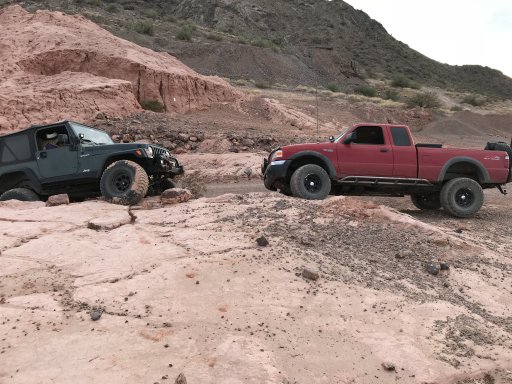

View attachment 39153 View attachment 39152 View attachment 39151 Hey guys! I’m new here and thought I would start off my introducing my truck and showing a few pictures! Always looking for ideas on how to improve it so if you have any ideas please let me know!
My truck is a 2002 Fx4 Ford Ranger with a 4” superlift, I ditched the torsion bars and did a coilover conversion with Fox emulsion coilovers. I also installed a set of BTF uniball upper control arms and running a set of 33x12.50r15 BFG Ko2’s. The truck has factory 4.10 gears and Torsen LSD in the rear. I built a rear swing out spare tire carrier bumper and have a 2 gallon Daystar cam can on the spare. I welded on a set of trail gear rock sliders for protection!

View attachment 47225 View attachment 47224
We’re fabricating rock sliders next, could you post some pics of the underside of your rock sliders?
The rock sliders are trail gear 84” (I believe) weld it yourself kit. They aren’t perfect length but close enough. See pics above.
