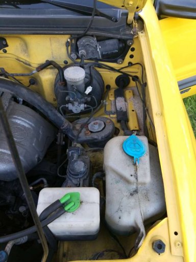

Got the camping box installed in my rig (still need to finish drawers and all the bells and whistles). Want to install second battery this fall. Just went out to measure and I can't see where I'll fit a second battery under the hood. The big empty space is a little too small. Any reason I shouldn't put it behind the passenger's side seat? Already removed the back seats with the camping box install. img_20190829_181004.375.jpegimg_20190829_182318.954.jpeg
