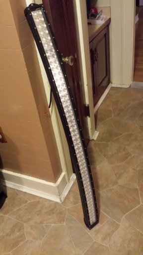

I have a ton of work ahead of me in the coming weeks, just ordered these goodiest:
50" Curved LED light bar
Upper windshield mount for the light bar

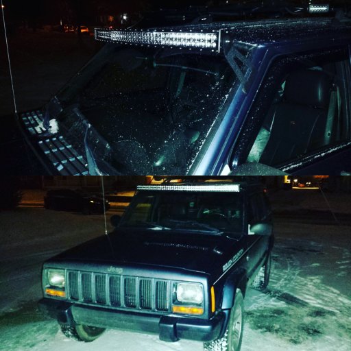

Felt like a picture kinda day!

That's rad! We need an off/on photo of it lighting up the woods now. :grin:
