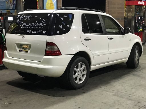

I was looking for an XJ to build for exploring and camping, but the good ones are picked through, or too expensive. I did some research, and I found that these early model Mercedes-Benz M-Series seem to be the best deal around. I picked up this ML430 (4.3L V8) with less than 95k miles, for $4000. I'll use this thread to show the gradual build progress. In the photos below, you can see that I let my daughter borrow it for her wedding get-away car. It's as minivan/mall crawler as you can get.
This weekend I'm picking up some LT285/70R17 BFG KO2s, and then we'll go from there.
