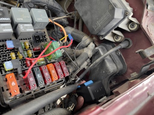

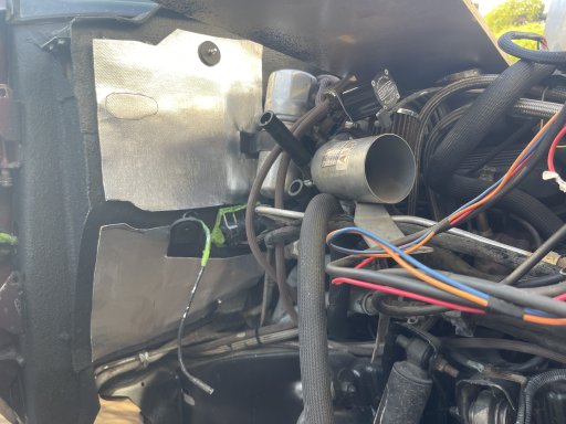

I had previously mentioned the issue with the traditional underwood electrical center was the maxi fuses. I looked up multiple alternatives from Bussmann, Gep Power Products, MTA, Dill Blox, etc... I had considered switching to J-Case fuses, Midi fuses etc.
After weighing out the pros and cons for my particular situation, I landed on Gep Power Products for the Underhood Electrical Center replacement. I began playing around with online configurators like the one provided by CEautoelectric.com (no affiliation, I dont have any affiliations by the way) and after a lot of back and forth, I came up with a solution I am still working on, below is some of the steps in the process for anyone who has to go through anything like this nightmare.
There are 2 main branches of wires feeding the UHEC. Here covered in loom. The traditional UHEC also has three B+ bolts. The two branches and 2 of the bolts can be seen here on the right side of the UHEC.
After Lots of pictures and studying the technicians manual to wrap my head around what is going on and what Im looking at here we began to slowly move forward. Here you can see the loom removed from the two branches. The one on the right is all the Maxi fuse circuits, the left is everything else.

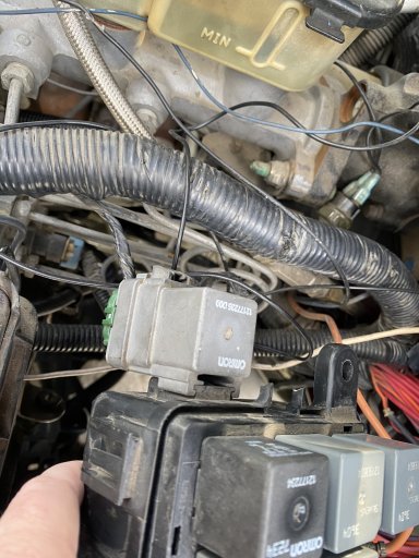

Originally the Aux fan relay sat on an external "rail"
The cover has the index for my particular UHEC.

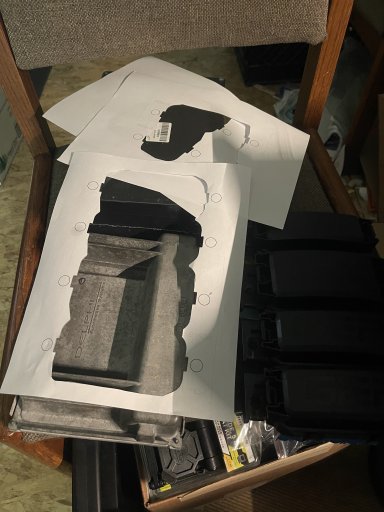

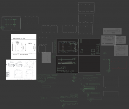

Here I'm testing out sizing of the system with the OE relays and a Gep 96 position PDM.

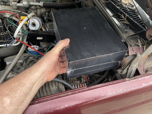

I bought 2 "project boxes" as a prototyping tool for housing the new UHEC. two sizes, here is the bigger of the two...no way this fits.
I downloaded the drawings and specifications sheets from Gep and worked them up in illustrator. Here's what the whole file looks like, ive got dimensioned drawings for all the iterations that are feasible and am able to play with them like puzzle pieces.
Here is the template cut out and the fitment.

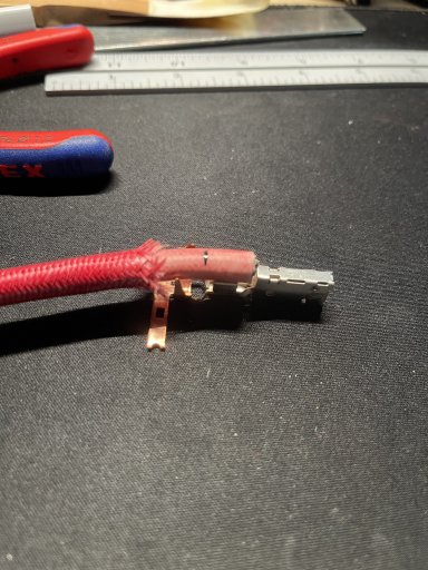

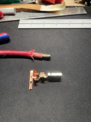

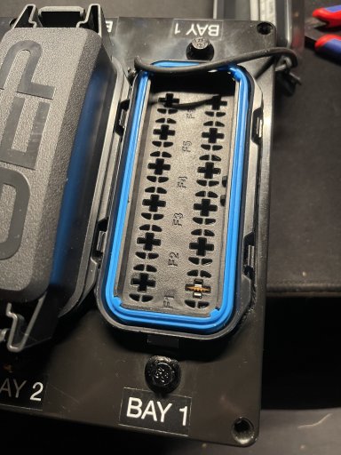

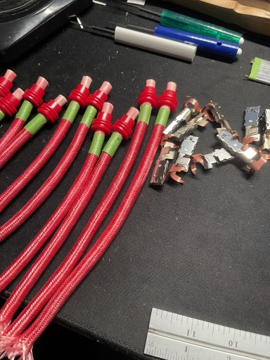

The Gep Power products Maxi fuse PDM moves away from the Aptiv system of terminals and instead uses the Lear Mak 8 terminal. The Lear terminals are quite robust and nice. There is one big downside as far as I'm concerned. Lear doesnt give good crimp specifications or have recommended tooling. This is really bizarre to me but here we are. So after talking with numerous people I bought a tool that was recommended for the job by two independent people with experience with these terminals. I am making a B+ bus to feed the Maxi fuses like the traditional UHEC.
Here is a bit of what that all looks like.

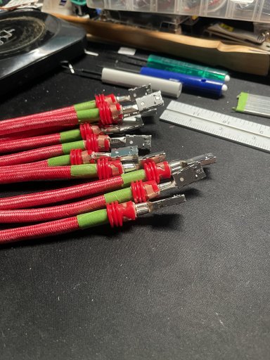

6AWG SRML and my preferred cutter for larger wire.
Cutting and fitting to size.
I like to add a drop of Deoxit D100 to the threads prior to the crimp.
There is also no crimper for the mechanical, or strain relief crimp. I had considered making a die but taking some time and slowly working the tangs with pliers (I used this wrench) worked out pretty well.
Heatshrink the fiberglass braid and install the terminal. It's a tight fit.
From the top.

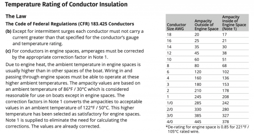

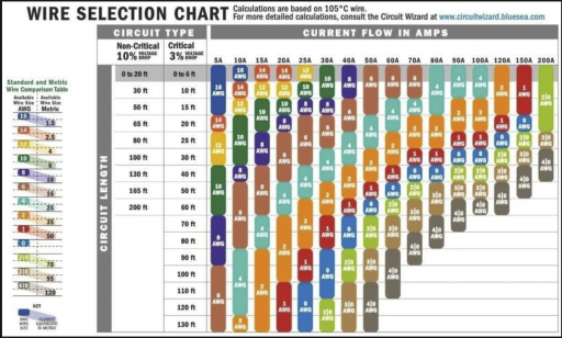

When designing a circuit, these temp ratings affect the ampacity of the wire, as well as the location and how it is installed. This is all incredibly important and is often overlooked. When choosing a wire, we need to consider if the wire is in open air or not. Often people design a circuit and choose a wire right at the edge of its ampacity based on a chart they see. Let's go through this with an example in mind.
Let's say we choose our example wire of Ancor 10awg wire. We are diligent so we look up the chart floating around the internet everywhere:
This chart, it's pretty safe to follow for a wire like Ancor. Here we can see we can safely use a constant 30a and if its a non critical (so not a sensor) we can run that wire up to about 30ft and we can expect up to about 10% voltage drop. Most people will just go for this and not think about it any more. This chart is everywhere because it is generally safe but it isn't actually a chart about ampacity. My 10awg Ancor branded wire, running 15ft from B+ source to load, in open air, with an ambient air temperature of 22c, running 30 Amps constant, will heat up, adding resistance. Is this safe? Sort of, it depends on how we define safe. Will the wire in this situation fail? no. But...What happens when the ambient temperature rises, what happens if I'm running a bunch of wires in a harness? What happens if that constant amperage sees a spike? What happens if this wire is touching something that cant handle that heat safely? The above chart is good to follow cause its about voltage drop and not ampacity, so it is more conservative.
Here is what Navico Group specify:
Here is where things get complicated. This is based on 30c ambient air temperature, the wire being in open air, even if in engine space. Even then...this is also the edge of what the insulation can withstand without degradation or even fire. What does that mean? It means that we should interpret this chart as saying the following:
My 10awg Ancor branded wire, running 15ft from B+ source to load, in open air, with an ambient air temperature of 50c, running 51 Amps constant, will heat up to 105c. That is hotter than boiling water. Is this safe? Sort of, it depends on how we define safe. Will the wire in this situation fail? no. But...What happens when the ambient temperature rises, what happens if I'm running a bunch of wires in a harness? What happens if that constant amperage sees a spike? What happens if this wire is touching something that cant handle that heat safely?
Here is where we run into problems and complications. This only gets worse when we add connectors.
This is why we rate our fuses to the wire, so the wire never gets to the point of damaging the insulation. Easy right? Sort of.

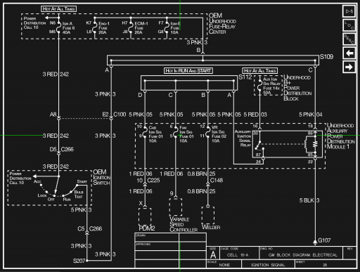

Here is an example in my own use where I have now had to change a design due to variations and differences from theory to practice.
Best practice is to keep OEM circuits unmolested. Added circuits and aftermarket systems should not interfere or even really interact with OE circuits at all. So my initial design was a small under hood PDM to integrate the ignition signal for all added circuits. Here is what that kinda looked like.
Well that ended up not working out for a number of reasons.

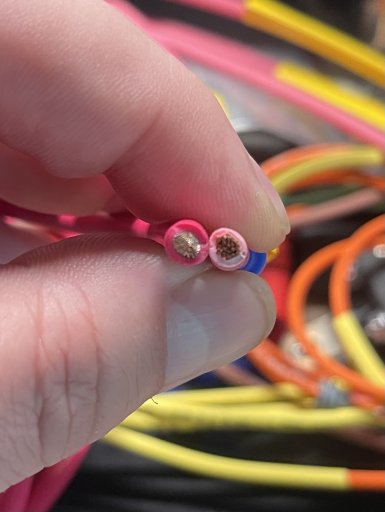

Now I am building a whole new under hood electrical system. So I have a new way to integrate into the ignition system, and it is still an attempt to minimize interaction. Here is what that looks like...

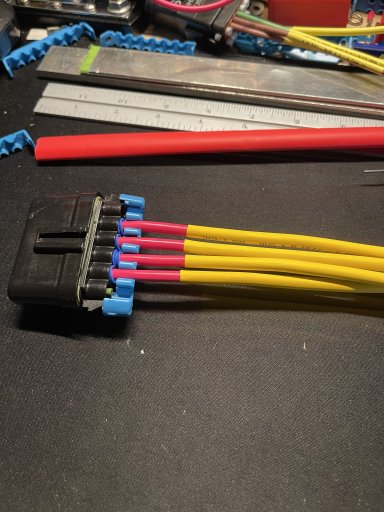

This wire here is "marine" wire that is pink 10awg. It is UL listed and is basically identical to Ancor or Pacer, but those brands do not offer pink in 10awg.
And here is a problem, 1. Marine wire is PVC coated so 105c rating which means further derating for underwood use...so upping to 10awg should work here, except...marine wire insulation is thicker (premium) so there is a fitment issue as these are now all compounding.
Here you can see two issues...
1) the silicone seal and strain relief doesnt quite fit with this thick of insulation, stressing the system.
2) the terminal position assurance clip, that holds everything together and assures strain relief and wire position will not fit.
So with that, what to do. Well, I could switch to 12awg marine wire, which would cut it close in terms of ampacity. I've chosen to go back to GXL automotive wire of 10awg. The insulation is slightly less thick. You can see the difference below. It's not much, but it makes all the difference. Now the wires will easily handle the power.
Here you can see the seals are all seated properly and the TPA is seated all without strain. The wire isn't tinned, nor is it class K, but it's rated to 125c and isn't going to be moving around so the Class C wire is a good fit. As well, I added Deoxit D100 to the fresh wire and it now sits in a sealed connector. This is a much better situation even though some would rather choose 12awg "marine" wire, which would fit, but in my opinion would be the downgrade here.

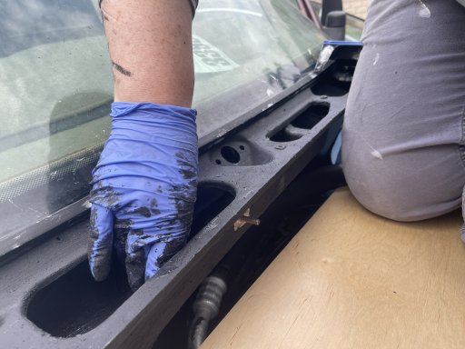

2025

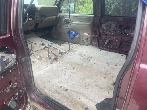

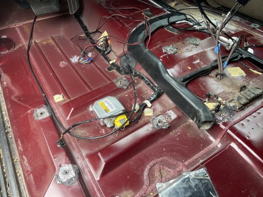

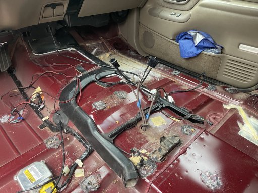

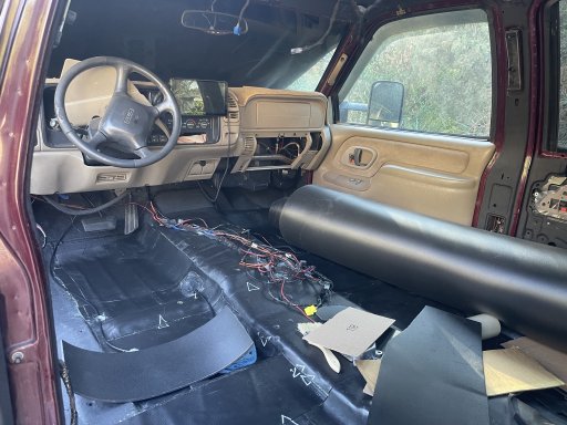

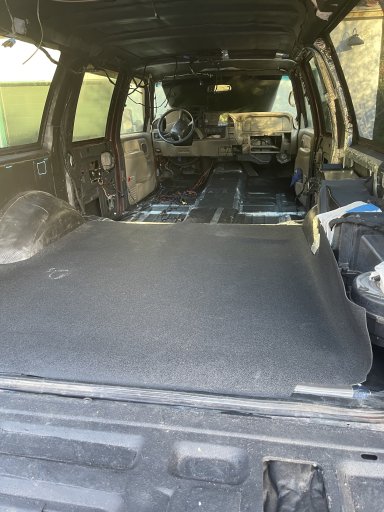

back to the interior tear out. We finally got the front seats, center console, and carpet out the front.

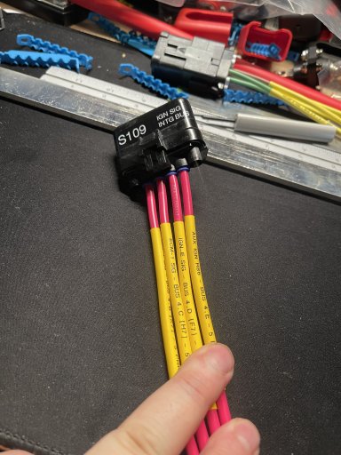

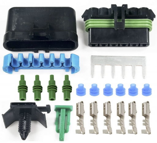

A quick one about bussing with Aptiv/Delphi and Deutsch style connectors.
Aptiv uses a "fir tree" clip, or one that some people refer to as a "rose bud" clip. GM has noted they do not recommend the use of the "fir tree" style clip for reasons I agree with, they tend to be a single use item.
here is an example of the "fir tree" style.
And here is an example of the "rose bud" style.
When buying a "kit" from Aptiv the Fir tree style is included, but it is much better to use the second style shown.
The Aptiv Bus is a really useful connection instead of splice clips, though it takes more space.

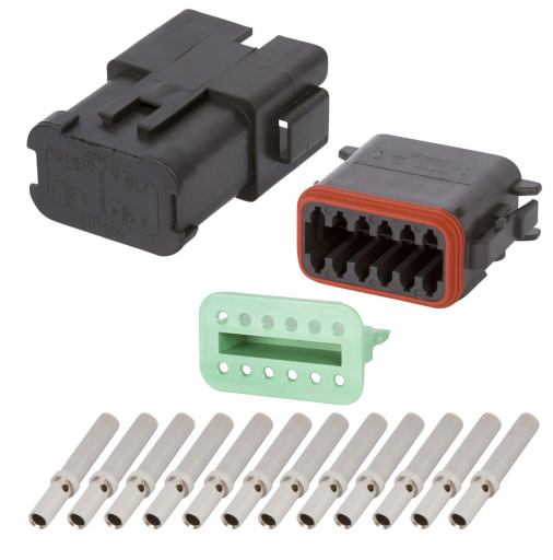

On the other hand, Deutsch and Amphenol have their own system. It is rated for less continuous amperage, has no inherent strain relief, but does have the benefit of being designed for constant fiddling, 100 connect/disconnect cycles with no degradation. There is also a higher variety of options. In the case of the larger numbered cavity options there is space savings as well.

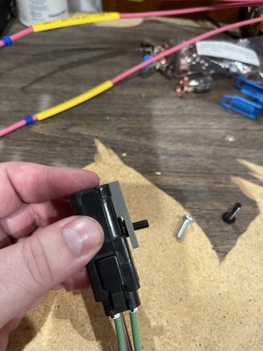

When attaching the Deutsch style connectors or busses, there is a very different system. I wanted to share a couple insights I've gained from using these.
Here is Bus DT04-12PB-P030 DEUTSCH DT 12 Way Black Quadruple (3/3/3/3) Bussed Connector Assembly Kit
To attach this style connector to a panel, there a a couple options, the design is different for the 8 pin and the rest in the DT/AT line.
Both of these have a stand off connector and a flush connector. I'll be showing an issue that will hopefully help others here on the flush connectors.
These connectors are not designed to be removed once attached, so plan accordingly.
Here we see the connector with an M5 button head bolt with a typical fastener head height.IMG_4593.jpeg
This will not work... instead use either a low profile head, or a wafer head fastener, like these...
So that installed you will get the result that looks like this (warning, attach the bolt and clip to to panel exactly how you want it before connecting the connector to the clip like in this image.)
