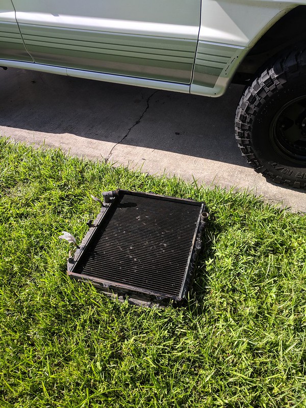

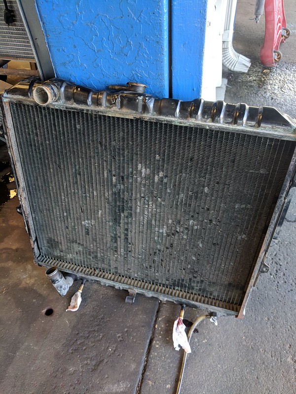

Its starting to get hot again in florida and after a week 1/2 of constant rain from that tropical storm a few weeks aga and cloudy days the sun has made it debut and its been killer the past couple of weeks. Last week heat index was above 100 degrees and a weakness in Groots cooling system showed up.
On normal street driving my temps are normal till I enter the highway where it creeps up above the half way point. I noticed this early in the week and it progressively got worse to the point the highest it got was right under the 3/4 mark on the temp gauge. Then normal street driving it was starting to float a tad bit higher than normal. I posted on facebook and got a overwhelming response that it was my radiator clogged. If anyone has kept up to my build...everything in the cooling system is new, other than my radiator. I was going to rod it out but didn't have time to and visually inspecting the radiator it looked ok and its been 7 months since.

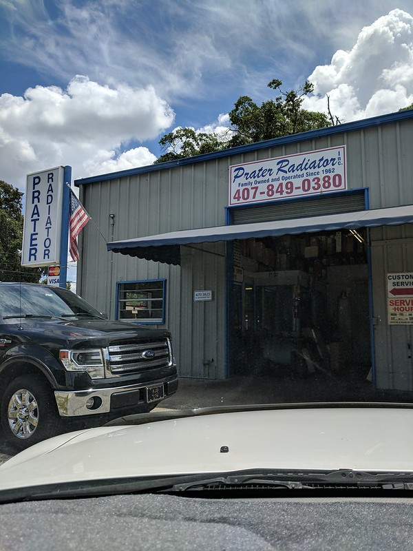

So I decided to remove the radiator and get it rodded out. Once I drained the coolant I already noticed the inside top innards of the radiator there was build up which backed up the suggestions that it was clogged. I took it to a reputable place in Orlando where I have encountered the shop before in the past working for Toyota and friends who had work done for them with their radiators and intercoolers called Prater Radiator. I took it to them and visually the radiator looks good for being the original from 98 and gave me a quote of $137 to get my radiator back to optimal condition.
Groot by grimgs, on Flickr
Here it is when I dropped it off. Should be ready tomorrow and update the thread accordingly.
Mrgalantguy

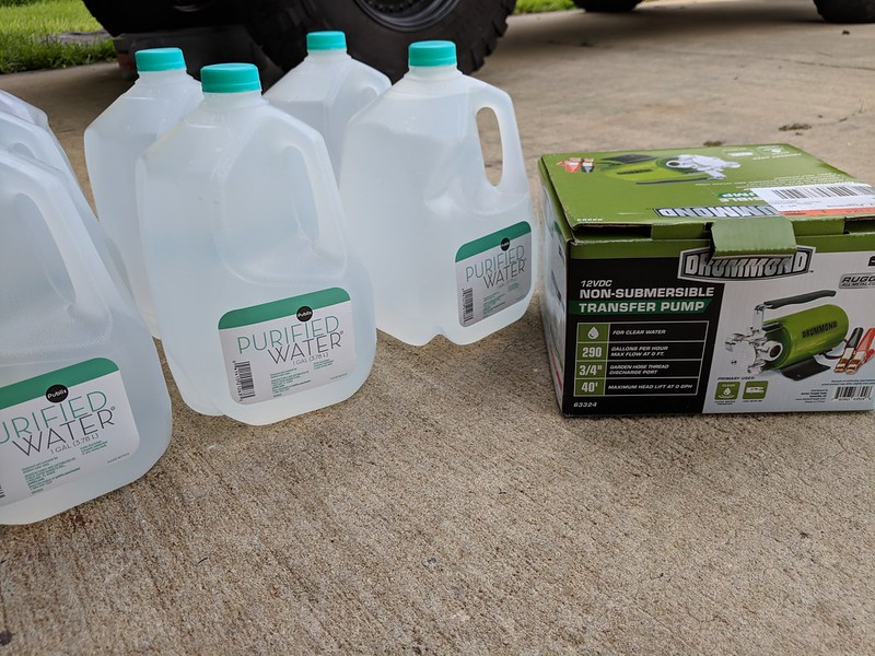

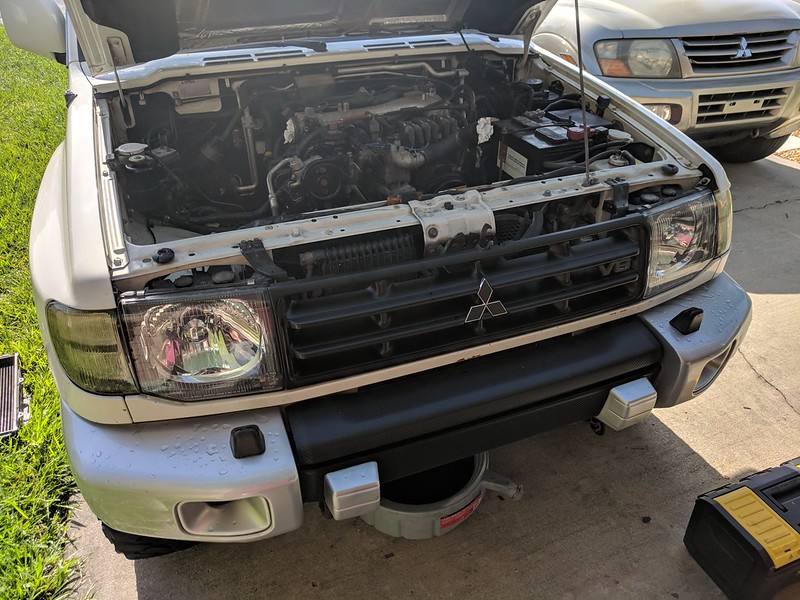

Took my radiator to Prater Radiator here in Orlando, FL and took them 2 days to rod out my radiator. They said it was clogged a good bit but other than that the radiator is in pretty good condition. The shop owner highly recommended me to flush out to remaining coolant out of my motor/system before I install the newly rodded radiator to get rid of any remaining material in the system that caused the clog in the 1st place.
I read up on the garden hose method but Florida tap water isn't the cleanest water. It has hard deposits especially limestone etc etc so I didn't want to flush my cooling system with that water. I came up with the idea to flush my system with distilled water and using a transfer pump.
I am very happy with the results as I was able to flush my system out and used distilled purified water while at it.

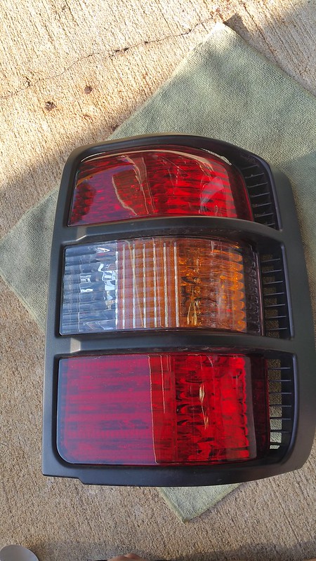

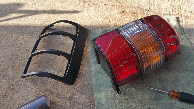

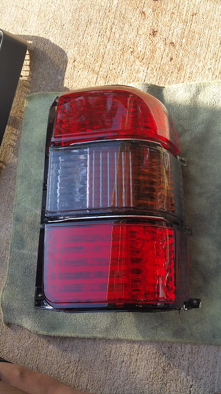

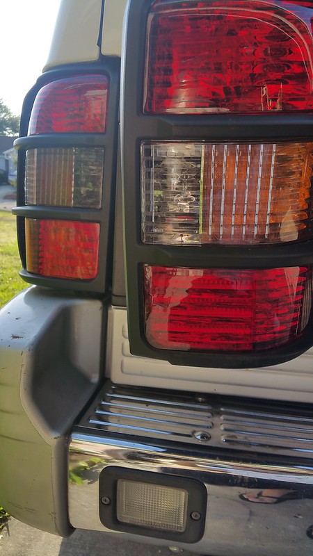

I got 2 pairs of Asian market taillights from my uncles vacation to Hong Kong a couple months ago. He got me a pair of Leibao tails and a pair of Pajero crystal lens taillights. The Leibao tails have some fitment issues as they are "taller" compared to the OEM tails. I am going to have to figure out a solution but in the mean time I am went ahead and installed the crystal tails as they do look better and have better light output than the OEM taillights.
Currently I haven't wired up the backup lights yet...waiting till I get some time remove my rear bumper to black it out and install the cree LED's in place of the stock location rear backup lights.
The only thing I wanted was a smoked out clear section so I got some smoke vinyl and applied it to the turn/backup section of the tails.
This is the crystal taillights and I swapped over the OEM taillight grille in place of the chrome grille they came in
This is after I applied the smoke vinyl
Smoked vinyl installed on the left compared to it being non smoke on the right.

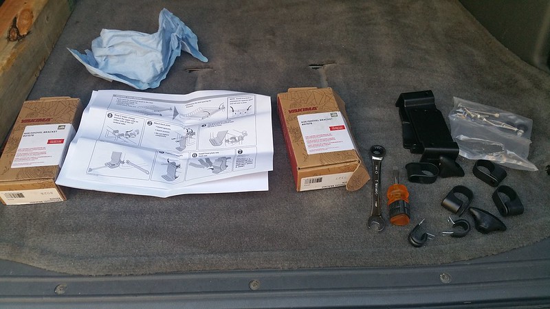

My wife got me some cool fathers day gifts...so I needed these Yakima holder brackets for the roof basket

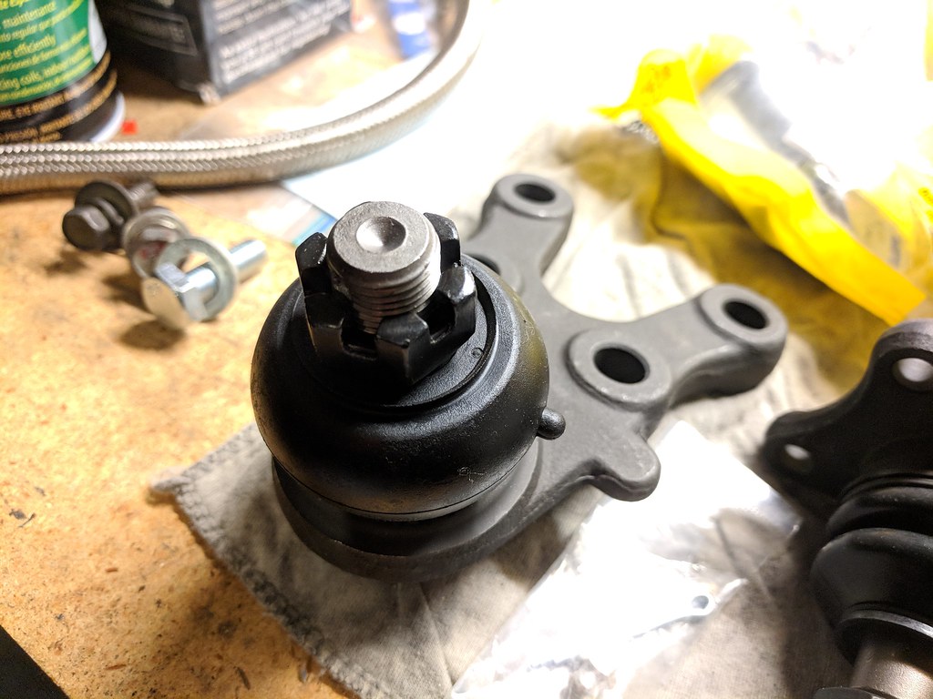

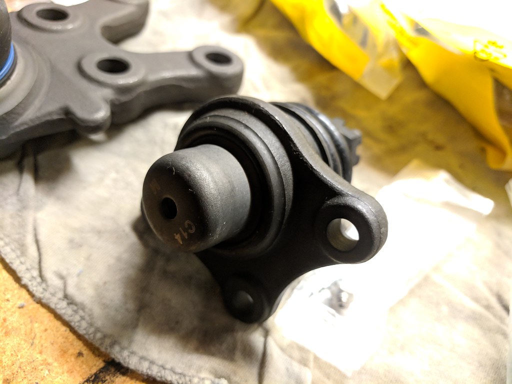

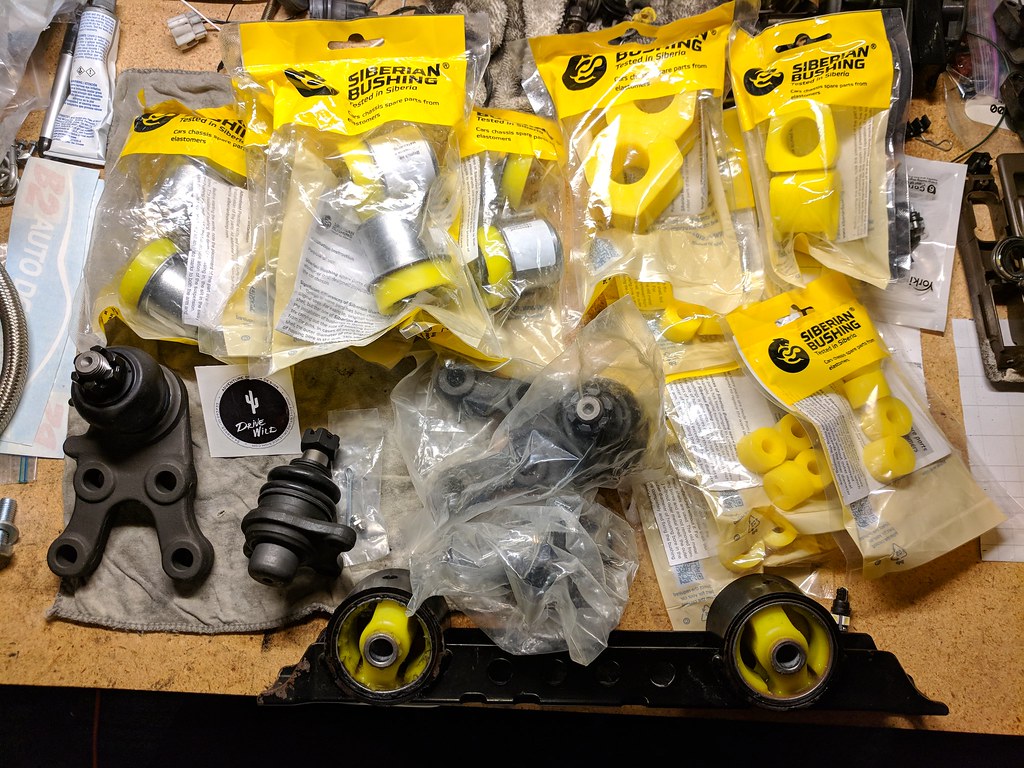

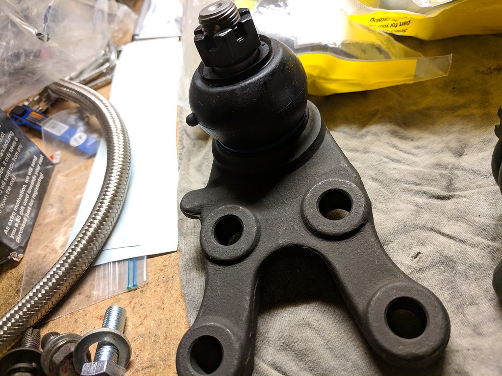

Groot needs a front suspension rebuild...so taking this opportunity to upgrade parts. ADD's (Adventure Driven Design) new chromoly upper and lower ball joints came in and Siberian bushings galore. I just need a couple more OEM suspension parts and the rebuild starts.

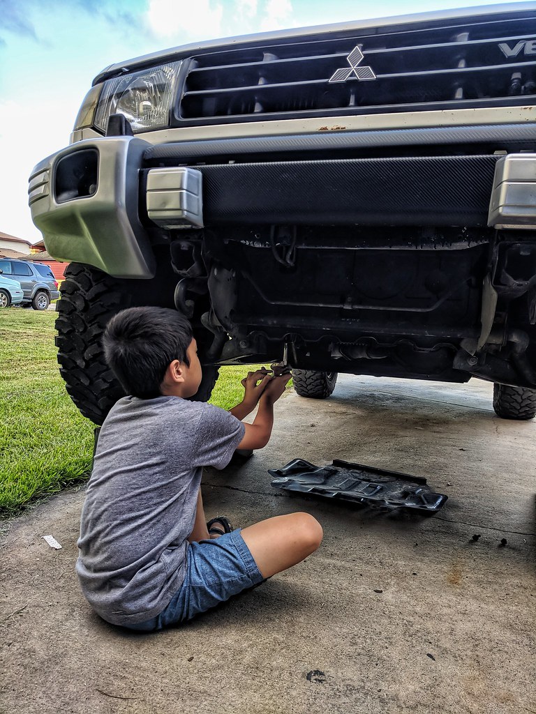

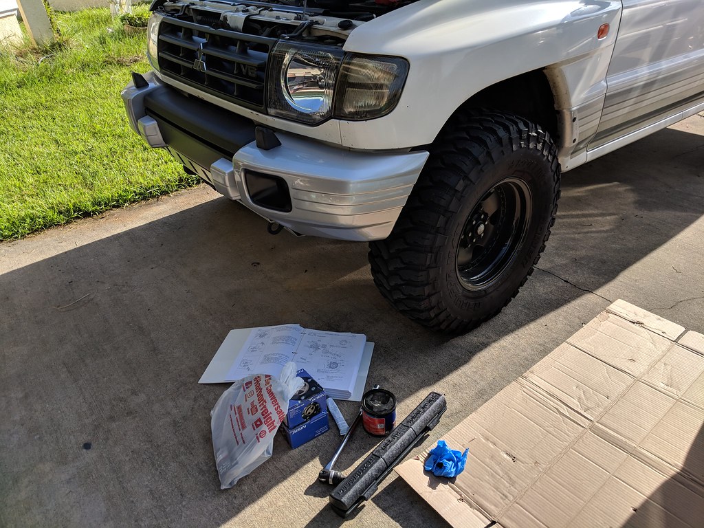

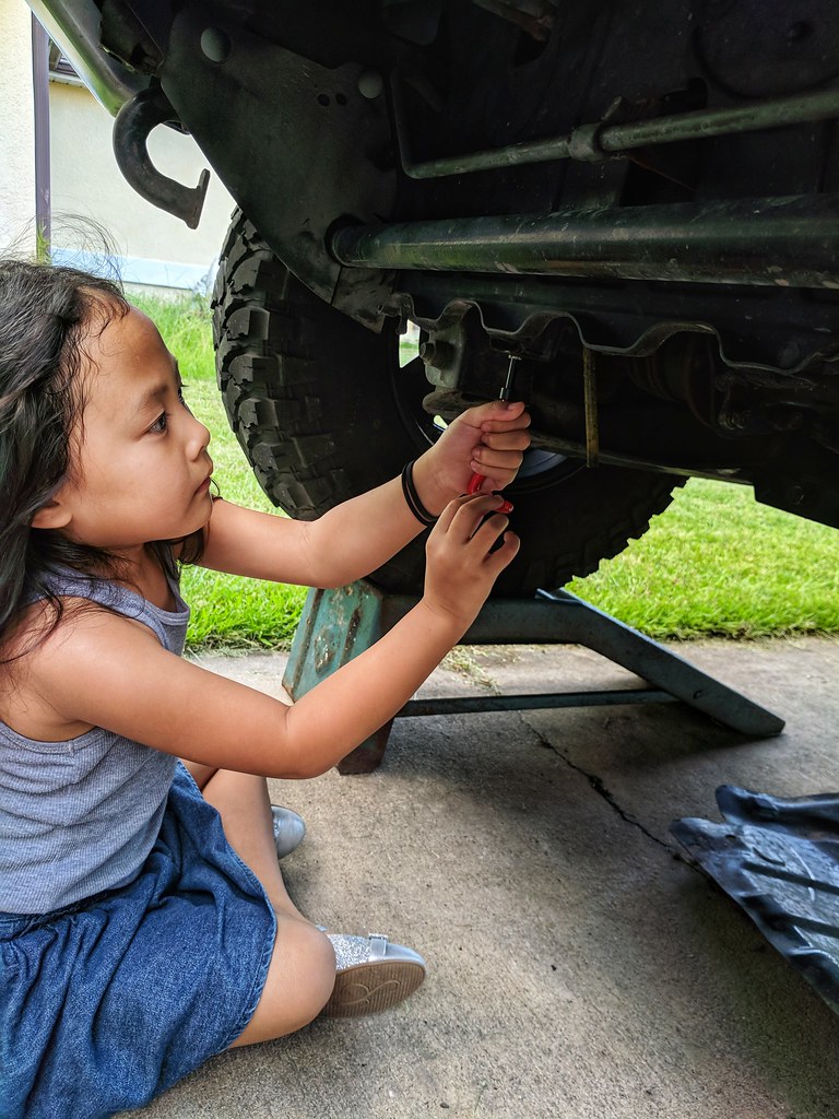

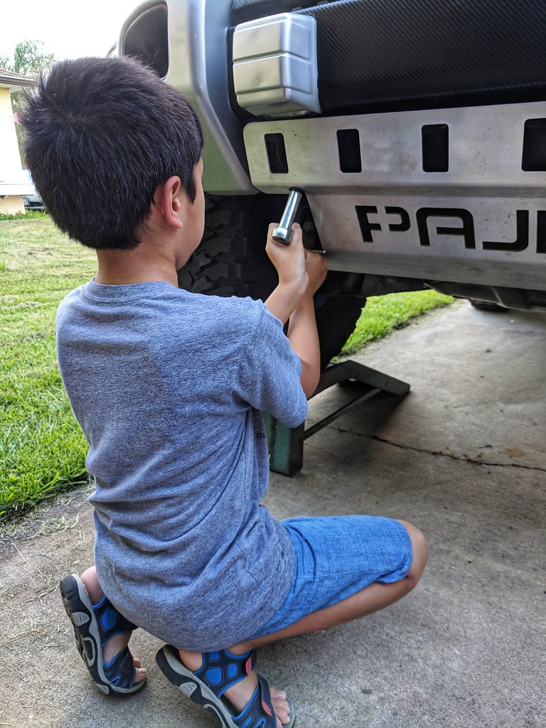

One of the bolt threads for the skid plates war barely threaded when I got my Montero and finally after the last oil change the last remaining useful threads gave up. I thought this would be a good opportunity to teach my son and daughter something and had them help me helicoil the stripped thread.
My son rethreading for the helicoil
My daughter installing the helicoil
Lil man tightening the bolts for the front skid plate.
