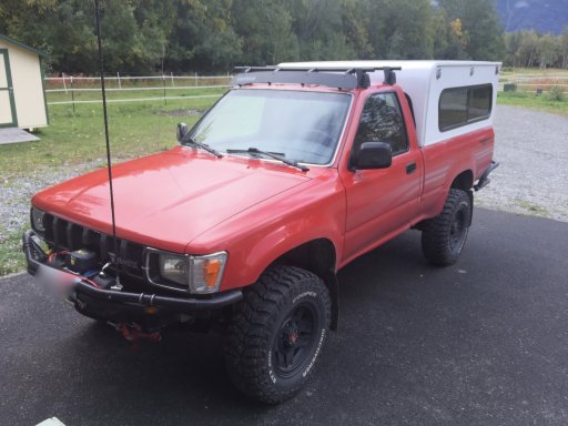

1991 Toyota Pickup SCSB "Ruby" (Picture Heavy)
alaskan.lad
1,721
Palmer, Alaska
Gabe
Hurt
6503

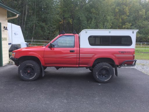

1991 Toyota Pickup DLX (carpet, roll windows, sliding rear glass)
22re 4cyl (estimated 110 HP with mods)
w56 transmission
IFS, 5 speed, manual hubs
Yakima 48” round bars/q-towers/wind fairing
LC high-flow thermostat
LC headers
LC 2.5 exhaust with cat delete
LC CAI
Optima Red Top
Plugs/Wires/Timing adjustment
Rear main seal
LUK clutch/throwout bearing
New starter (napa)
New alternator (napa)
New OEM master cylinder
New belts (PS & Alternator/fan) (no AC)
Napa 1515 oil filter (larger capacity filter for tacoma’s, but will work on the 22re)
Block heater
Trail gear F/R tube bumpers
Trail gear LED blinkers F, LED rear brake, turn and reverse lights

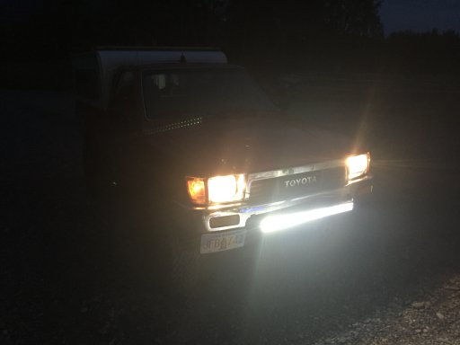

Vision X headlamp housings w/ HID factory 6000k LED bulbs
Low Range Offroad LED dome light
Bosch windshield wipers
Wilson 4’ CB ant./ Cobra CB (nothing special)
Upgraded sound w/hands free & bluetooth (kenwood deck, focal door speakers/tweeters & powered sub.. wanted to keep all the cab room I could, but still love me some bluegrass for the open road)
Bilstien shocks all four corners
Rocky Ridge locking hubs
New rear wheel bearings
Lucas in front/rear diffs, transmission/transfer case
Tuff Country AAL in rear w/ new leaf spring bushings
1/4” wheel spacers in front only

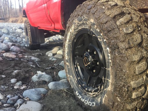

x5 Cooper STT Pro 30x9.5x15 on x5 OEM Toyota aluminum SR5 rims that were professionally powder-coated
All 4 balljoints
Front sway bar bushings
New front calipers and pads
New rear drums w/ parking brake adjustment
Replaced old shot bench seat with bucket seats out of an SR5 model. After pressure washing the filth off and drying, covered with NorthCore camo seat covers off of Amazon (from UK)
Ammo can center console
Hard mounted fire extinguisher inside cab between seats
TG mountain shift knob/ TG 2WD-4WD shift knob

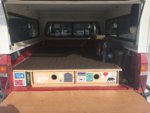

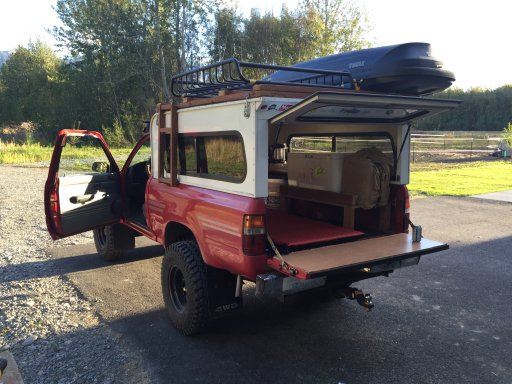

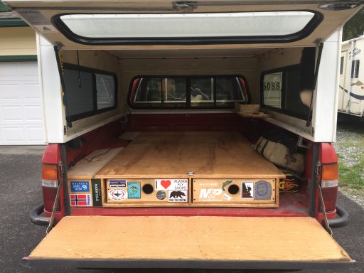

Custom built insulated canopy sourced locally, wood framed, insulated and wrapped in some high density fiber sheeting. Topped with a wooden rack that is easily on and off that has a yakima basket hard mounted and room for the canoe on one side.

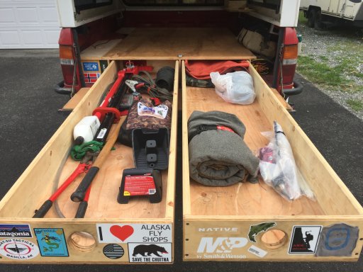

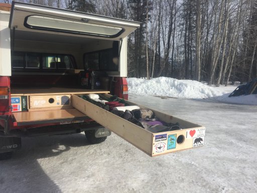

Rear camping boxes - two full length drawers, with two cubbies on one side of the bed, and open along the other side.
To be installed :
R151 transmission from 22RTE
Yukon grizzly locker (installed)
Trail Gear 10K winch with 100ft synthetic line & TG aluminum fairlead (installed)
Rear tire swinging gate
Battery tender/Oil pan heater tied in with the block heater then onto a 3 way shorty extension for sweet starts during the cold months here. (installed)
History - bought the truck with 179,xxx on it out of SLC when I was living in Pocatello, ID. The guy had a hard time walking away from it, as I probably would have now. However then, it was pretty ratty, besides a decent wax job. It was sitting on 17” FJ cruiser black steelies with bald BFG M/T's that came out to about 32’s. It had its fair share of body dents (some small, a few large), as well as real rusty rear bumper, blown shocks, dirty engine bay ETC. It ran decent, as it always has, but there was things that needed addressed before it was going to make the road trip to Seattle to be barged up back to AK the following spring. Pretty much everything preventative was done in ID, with the real build beginning once it found its way back home.
Sometime in the winter when the wax wore off I noticed that the entire front clip, and tailgate are painted a different red (with a crappier paint job) than the rest of the body. I surmise that at one point there was an accident, but the title was clean and clear when I purchased it. Not sure if it has affected drivability, and I was able to get a clean AK title (not that I would ever sell), so it never really bothered me. Gives me a good reason to break out the carnauba once in the while. Ive considered a full body restoration, but its not likely anytime soon. Maybe for her 300k birthday.
The truck just broke 200,000, and with no real maintenance history, I have already filled a 1” binder half full with receipts. It runs great, all 22re’s love getting dipped into the torque band, but this 22re out of the prior 5 I have owned is by far the fastest.
Based on the build sheet, you can kind of see the direction it is going. I would love to SAS someday, and surely will, but the platform of the truck is made for longevity if not overly modded out. I haven't even touched the torsion bars. The truck has been built to DD, and run mild trails locally, as well as strike out on the long empty stretches of highway here in Alaska. I wanted a multipurpose rig, and have always had a soft spot for SCSB Toyota’s. “Ruby” affectionately named has filled that gap for me, and she gets a lot of compliments on how clean the body is for the age and generation.
With everyone running high end rigs these days, i’ll bring up the rear in classic style, slow and steady!
Will start posting older pictures first, then take some new pictures this week. Any questions? Fire away!

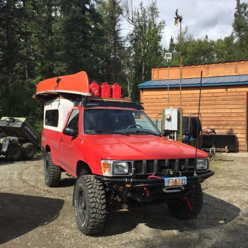

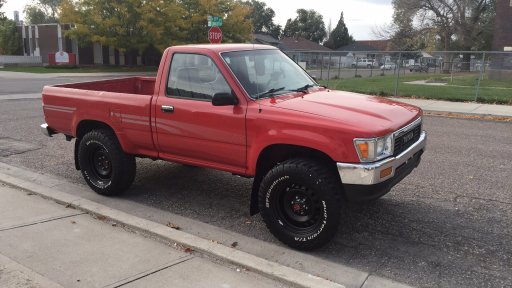

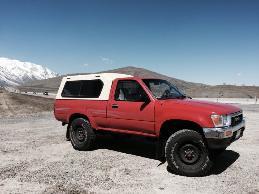

the day I bought it.

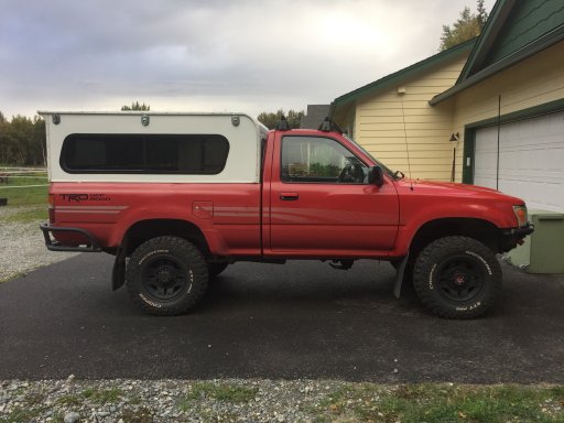

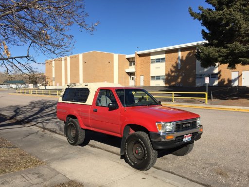

the following spring with some new tread on the 17's (general grabber, good tread) and a canopy I picked up to keep things dry.
little road trip action in UT

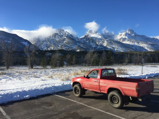

Grand Tetons, WY. In this shot you can see the major body damage, the ding behind the cab and as well as the fold on the runner where someone put it on a rock somewhere, maybe in the same incident.

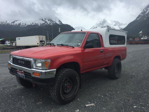

back in AK with the new topper

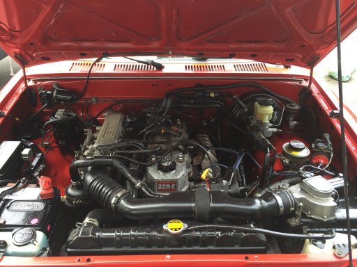

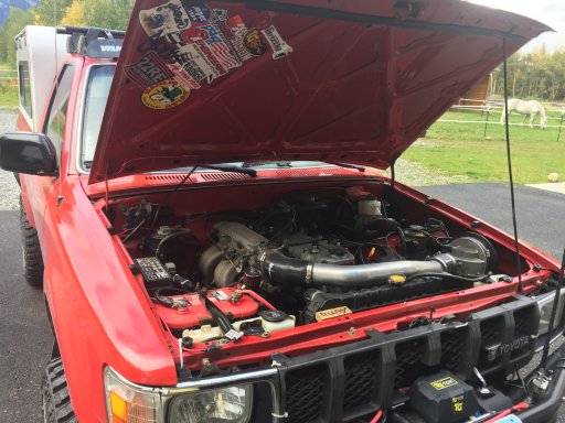

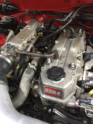

fresh detail on the engine bay

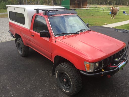

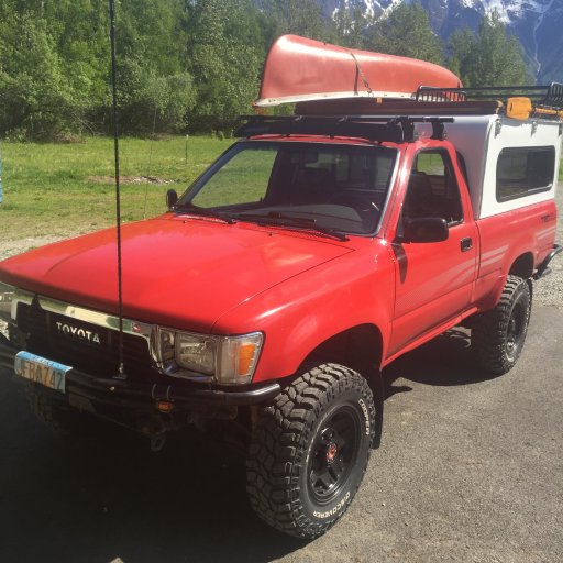

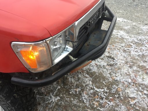

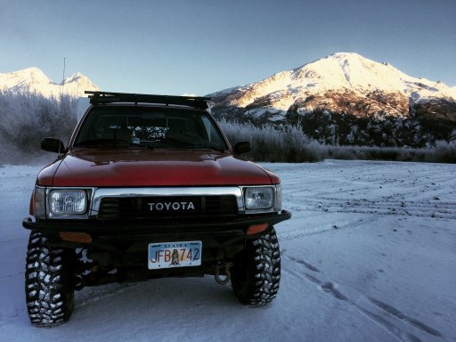

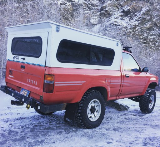

TG front bumper, and the first shot of the 30" STT Pros on the 15" SR5 rims

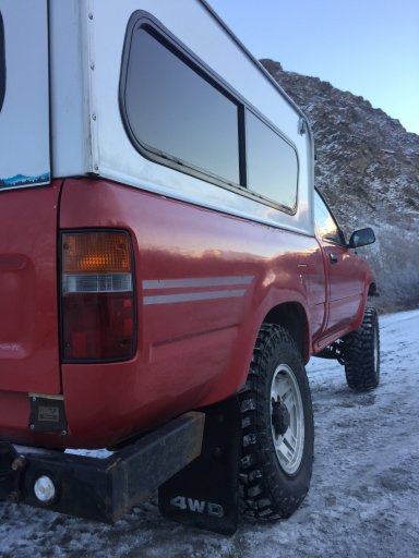

#swaybar #noflex but a decent shot of how the tire and rim set up turned out.

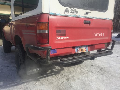

the rear TG bumper, gotta love that fender protection.

the rear boxes, will talk more about those later.
IMG_3016.JPG IMG_3217.JPG IMG_3237.JPG IMG_3303.JPG IMG_3306.JPG IMG_3307.JPG

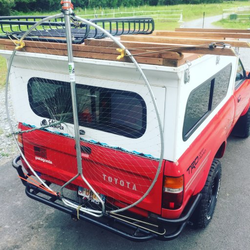

Did a little salmon fishing this week, had to improvise a rig to attach the dip-net to the truck. Worked good! IMG_3461.jpg IMG_3456.JPG IMG_3462.jpg

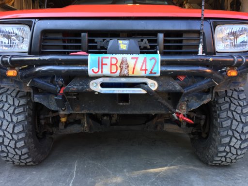

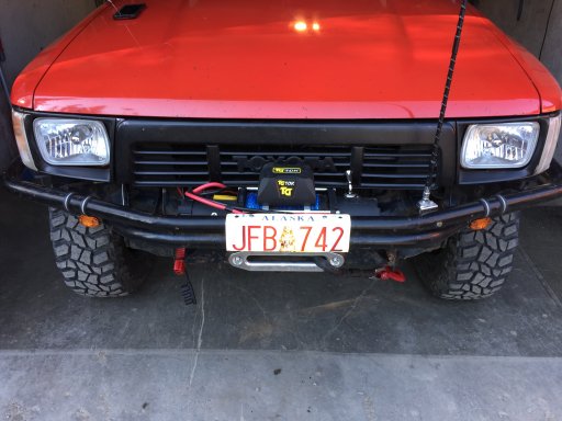

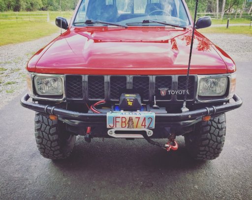

Installed the winch today, along with quick connects so it can be unplugged when not in use. Put a quick connect on my jumper cables as well, to make for super easy jumps. soldered all of the connections for longevity purposes. The install went fairly well, being a Trail-gear winch going on a TG bumper, all the holes lined up and came together well. TG aluminum fairlead. Got the synthetic line wound up on it, and had time to rattle-can the hook red. Impressed with the reel speed, as well as the design of the winch (TG 10k). The real test will come when a tree needs to be moved or the truck needs moved out of a hole. There was some clearance issues with the grille, and a it needed to be cut just a little in the middle. The grill is temporary, as I have an 83' grille swap in the works :), but it looks decent for now.
The rear diff went in today as well. Toyota 8" rear that was tore down and rebuilt on the bench with new bearings and such - Yukon Grizzly locker went in at the same time, then it went into storage until got some free time. Install went good, and was just about needed due to seepage at the seal on the cover. Rattle canned heavy with Ferd blue. Quick trail run - WHAT A DIFFERENCE. The locker performed flawlessly, and I was able to crawl everywhere I pointed the truck in just 2lo. There is a bit of a surge when getting back onto the gas going around corners, but it's only momentary, and may lessen as time goes by and things get broke in. Running 80-90w Napa non-synthetic. Long term review will come later, but I would recommend this locker to anyone looking to get into a streetable mechanical locker.

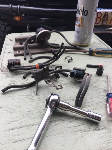

Also this week deleted some emissions tubes to free up access to valve cover, thermostat housing, injectors etc. that was buried underneath the tubes. Picked up rubber caps from Oreillys, and went to town. It seems to run better not having a bunch of stuff re-circulating into the system, and makes for a simpler engine bay when diagnosing issues.

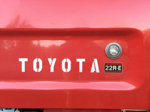

And got my emblem on!

Finished the 1983 grille swap, after much trimming and a few different zip-tie configurations. Besides ordering the grille off of ebay, I also ordered vertical headlamp doors as my original ones were slanted. Pretty excited about the way it turned out, though the chrome is not really something I am a fan of. Plans to get some black sticker stock to cover it up, as these front clip chrome trim pieces are notoriously hard to paint.
Some more preventative maintenance before the trip was a valve adjustment, about half were too tight, with the other half not needing any adjustment. It was the first valve adjustment I had did on the truck, and wasn't sure if it had been done in the previous maintenance history. Also replaced the plugs, wires, distributor cap and radiator cap with OEM parts from 22re performance.com, what a difference! I had never run OEM plugs or wires in any of my prior 22's, and I can honestly say I will never run anything else. Besides smoothing out the engine, I gained 3mpg, better throttle response, and a cleaner engine bay. Worth every penny.
As far as the locker report : off-road I couldn't be happier. Took the truck down a bouldery, muddy tundra trail, and the combo with the locker and 30's got me as far as a buddy on 33's only getting stuck twice, because of heighth issues. After 500 miles of hard highway driving I change the diff fluid, and it has softened up quite a bit. Still a bit of surge when getting onto the gas around corners, and on hard starts it wants to walk a little bit due to the traction, but its nothing that I can complain about. The locker has only popped once during a corner (loud), but apparently this is a thing and I haven't been worried about it. It disengages well in parking lots and on sticky surfaces, I am completely happy. Looking forward to some winter driving to see how it does in 4wd on highway and around town.

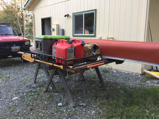

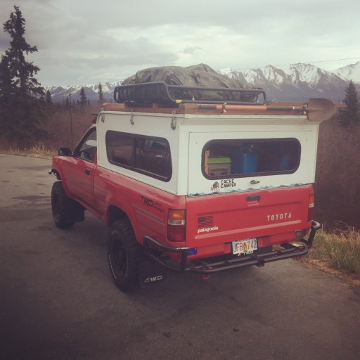

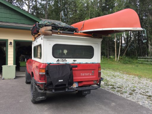

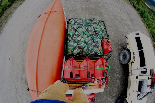

I was able to tighten up my adventure rack configuration to comfortably hold most of my gear, 15 gallons of extra gas, canoe, and hi-lift. I know they say thats its not ideal to have a bunch of weight on the roof, and I could definitely feel it more in the corners, but by driving conservatively and pre-emptively I would feel comfortable running it for extended periods on the road. Even managed to get 19 mpg on the trip!
Now for the trip pictures :
IMG_3622.JPG IMG_3624.JPG IMG_3662.JPG IMG_3663.JPG IMG_3664.JPG IMG_3665.JPG IMG_3672.JPG IMG_3341.JPG IMG_3380.JPG IMG_3443.JPG IMG_3410.JPG IMG_3425.JPG IMG_3647.JPG IMG_3650.JPG

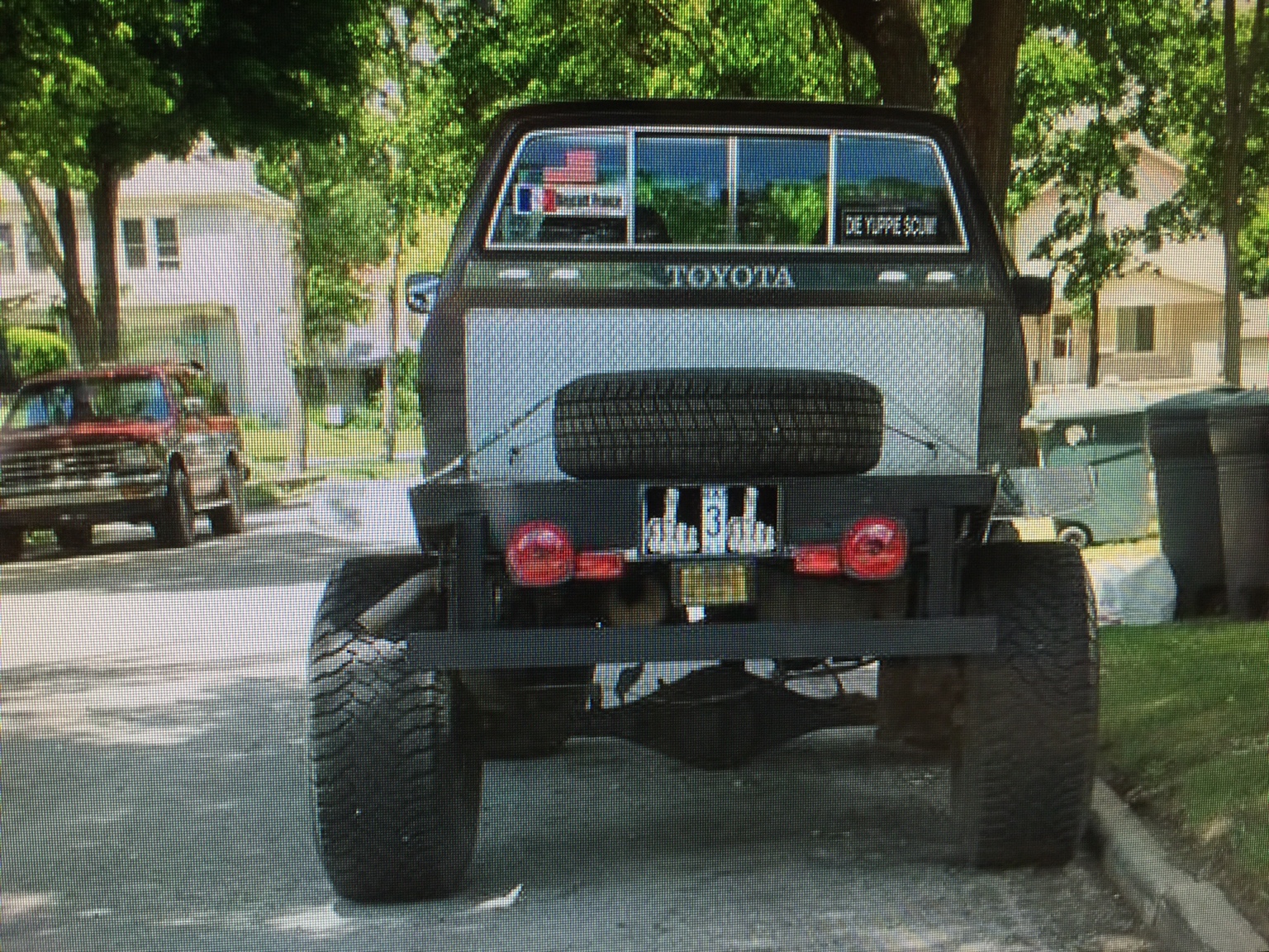

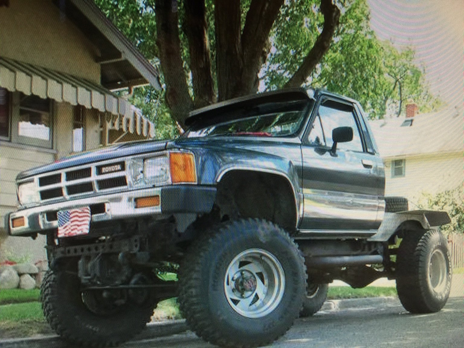

I gotta say, this is one BA rig! Had an '87 and an '84, the '87 was bone stock but fully capable. The '84 was originally a show rig lifted an ungodly amount that I do not remember but had either 33" or
35"s on it. The bed which had hydraulics when I bought it was a huge pile of rust so I literally ripped it off and just went with a stubbyflat. It had diamond plate covering the frame so I just cut a couple pieces and made some fenders for it. What a fun truck though. Sadly the tranny went out on both trucks (5speed) so I went to a '98 4runner which I hated the payments on so I sold it and got an '87 4runner which at the time, they weren't the "collectible" that they are today. Anyway, awesome rig, I am fairly jealous... Had two celiacs one with the 22r and one with the re. Both pickups were 22re's and the two 4runners were V6's now my '06 has the 4.7 and it's a monster but those 22re's... never heard a bad thing about them.
