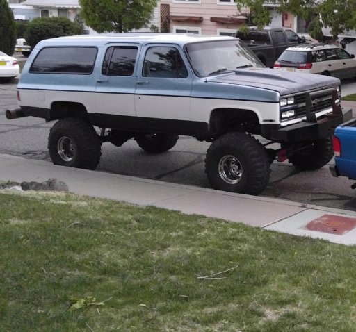

So a couple years ago,I purchased the suburban. The body is straight it has 10” of suspension lift and came with an extra Chevy 350, a 700r4 and a NP205. The interior left something to be desired. So that is my starting point. About 4 months ago I was driving around town and noticed the 350 that’s in the suburban now could not keep up with the big truck, so I set out on a quest...

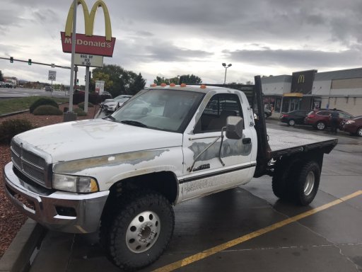

About three weeks ago I purchased a 1995 dodge 3500 4x4. It has the 5.9l Cummins. So the dodge is going to supply the motor, nv4500 transmission and the suburbans np205 transfer case.
Thoughts,comments,and advise is greatly appreciated

View attachment 75567View attachment 75568
Love the look....2 tone paint...it's a rig that I can't wait to see get built

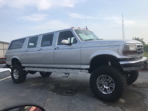

Recently spotted at my friendly neighborhood used truck dealer:
90's Bronco sitting on a Dodge Cummins powertrain. TWO crew cab donor trucks used to stretch the cab. If you can dream it, you can build it....;-)

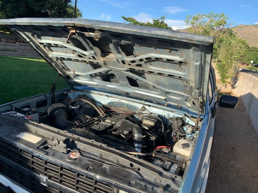

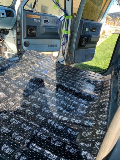

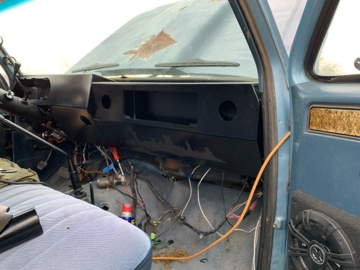

It’s been awhile, an updated is long overdue. Since COVID a lot has been done to the rig. Starting with the motor, like mentioned above the Cummins 12v did in fact replace the 350 sbc. Behind that is a nv4500 coupled to a np205. Then I started working on the interior. I ripped out the old carpets and patched a few holes were the rear heater use to be, after that I began the time consuming but kinda therapeutic task of sound dreading the floor walls and roof. Along with that which is still in the process. I decided to switch the interior color from blue to black. To top it all off I started to tackle the wiring under the dash what a challenge that has presented. Any questions or comments are greatly appreciated. Thanks

What kind of sound deadner is that? I order a roll off amazon...fatmat. Havent gotten to install it yet. But curious how it went on, any trouble, tips for install.

That is a product from Amazon as well it’s called mat 66 80 mil, it comes in a box and each box covers about 36sq ft. With sound deadening you want to make sure that it doesn’t have asphalt in it or it will melt at high temps. Mat 66 is made of Butyl which does not melt or smell. For tips I would suggest investing in a set of rollers, the different sized let you get in the corners better. And the more surface contact the sound deadening has with the metal the more efficient it is.
The rollers are also on Amazon
HAOFANG Car Sound Deadening Roller Tool 5 Pcs,for Auto Noise Roller Car Sound Deadener Application Installation Tool Rolling Wheel Interior Accessories https://a.co/d/dDl1svV
